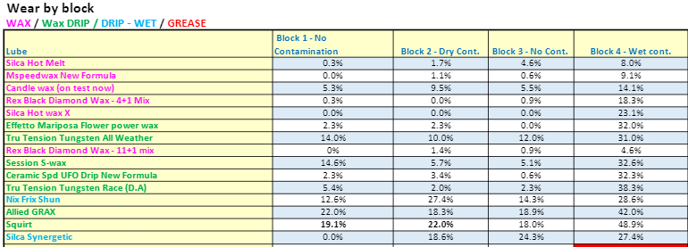

Those conditions are the worst to run a wet lube, counterintuitively. You’ll attract much more dirt to the chain and wear things out faster. Wax can sometimes sound dry/bad so people think it’s not effective, as per above it’s likely the best option. Even a drip wax can be ‘wet’ enough to attract dirt so the best option is a solid lubricant. ZFC’s chart tells the story really, looking at block 4 in this instance:
If that chart is accurate to real life, you’re talking about getting ~3000k from a good drip lube and ~8-10,000 from an immersive wax treatment. Some wet lubes will rip through the chain in around 1000k so either option is better than those!

Just a note on those Zero Friction “tests”- the wet lube tests never have the chain cleaned. That to me is misleading. And I understand the waxed chains are not either, but that’s an entirely different method and product. Also, not to put down the ZF process, but it is a bit sketchy and backyard.

Drip wax isn’t either, it still wins (although by much less)
Also I’m my experience of people using wet lube, not cleaning at all is pretty representative of real life use…
