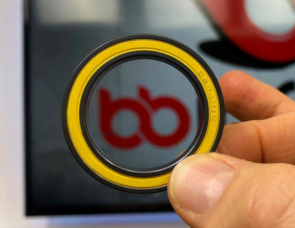

Thanks. This is looking increasingly like the way I will go if the second attempt with loctite 641 doesn’t work. I emailed their customer service and they have said I need this one:
It’s $350 which seems a lot compared to some of the others?
Anyone know if they have a UK or EU sales outlet?
That is for their highest level ceramic bearings, akin to CeramicSpeed stuff. Their steel bearings are 35% cheaper
Aha! So they tried to ‘up sell’ me :joy:
Can’t blame them for offering their highest quality item I guess.

You can buy the BBInfinite insert without bearings. You said you have the Hambini higher quality Japanese bearings. Use those.
Also, if the color you want is not available without bearings, email or call them and they’ll get you the color you want. And, when it comes to install, don’t hesitate to email them with any questions. They’ve very responsive.
Are you sure that’s possible?
BBInfinite appear to be using a smaller bearing so that they can fit the 1mm thick sleeve between the 42mm BB shell and a 40mm bearing. This is not a standard bearing, unlike the TNT, SKF or FAG bearings that you get from Hambini.
That’s the reason he doesn’t make a BB that works in a 42mm shell with a 30mm spindle.
Mike
Mike - Good point. It looks like you may be correct here. I am running Campy on my Synapse. For the Campagnolo BB30A, BBInfinite offers a “without bearings” option, which is what I bought since I had a perfectly new set of Campy bearings that came with my groupset. I didn’t realize BB30A “without bearings” options are not offered on their website for other groupsets.
The best way to clarify is to contact BBInfinite directly.
If indeed this is the case that only the Campy bottom brackets are offered with a “without bearings” option, I confess, I’m not sure how to receive this news. As a Campy user, I’m not familiar with the experience of having options.
EDIT — RE their blog post about the 4030 bearings: those are only for their brackets made for 30mm spindles (bold emphasis added):
We use the 4030 bicycle bearing in our BB86-30mm and Dub, BB92-30mm and Dub, BB30/BB30A-30mm, and our English/Italian threaded BB’s for 30mm and Dub.
BBInfinite sells bottom bracket inserts and replacement bearings across the range of standard sizes to accommodate all of the common groupsets.

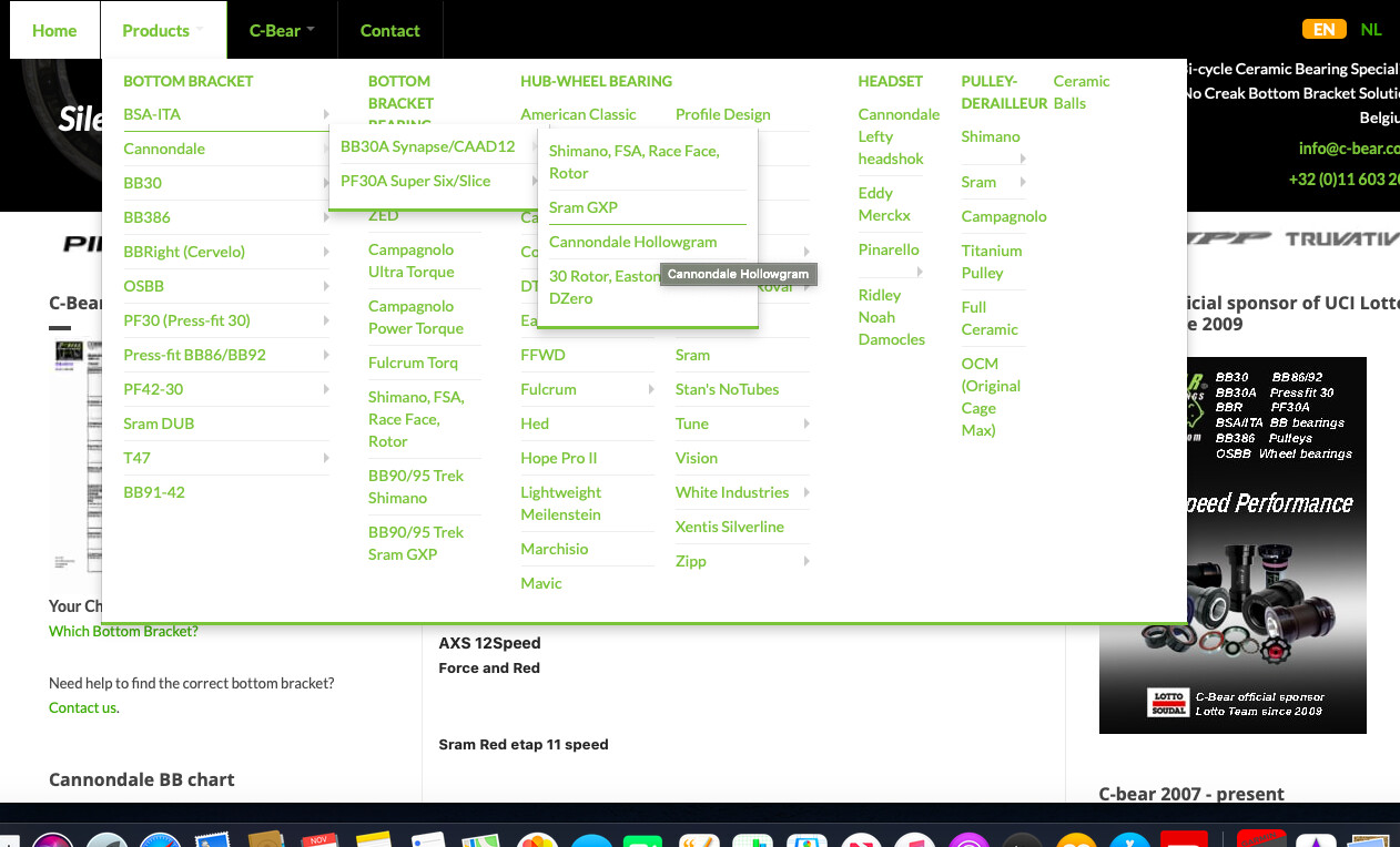

I’ve eventually gone with the C-Bear solution as it appeared (from various searches on feedback) to be reasonably well liked by buyers and represented reasonable value for money, as well as being available for next day delivery from a UK suppler.
I will report back on success (or otherwise) after installation.
Thanks for everyone’s help and advice :smiley: :+1:
How did your solution work? I’m facing a similar issue with a Cannondale synapse and would rather not replace the cranks. Also could you link where you purchased the part for repair? Many thanks!
Actually the solution has been really good. So far there has been no problem to note. Circa 4000 miles without any issues manifesting.
If you just Google search etc CBear website - then the product link for Cannondale (as per screen shot below) takes you to what you need.
Edit - they sell them at Sigma Sports in the UK (see below)
