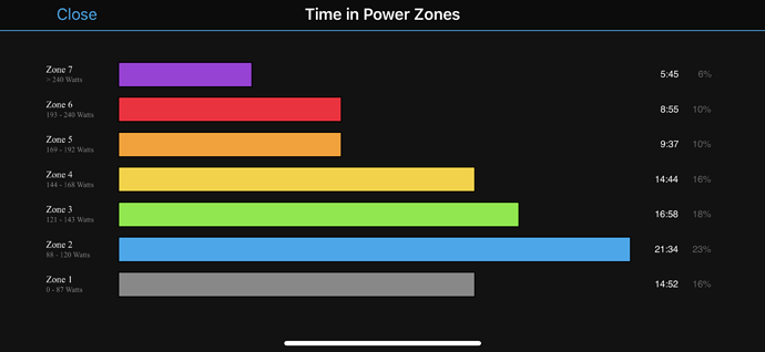

My FTP is only 160. That means on a normal bike ride, just getting up hills requires spending time well above that. Combine that with the fact that I live in an area of rolling hills, and any outside ride is a decent challenge for me, I think that means I need to build in recovery.
For example, yesterday was on “off day” on TR (I am doing SSBMV), I went on a 1.5 hour / 21 mile ride. Power numbers were:
AVG Power: 135;
Max Power: 444;
Max Avg Power (20 min): 147;
NP: 158;
IF: .983;
TSS: 148.

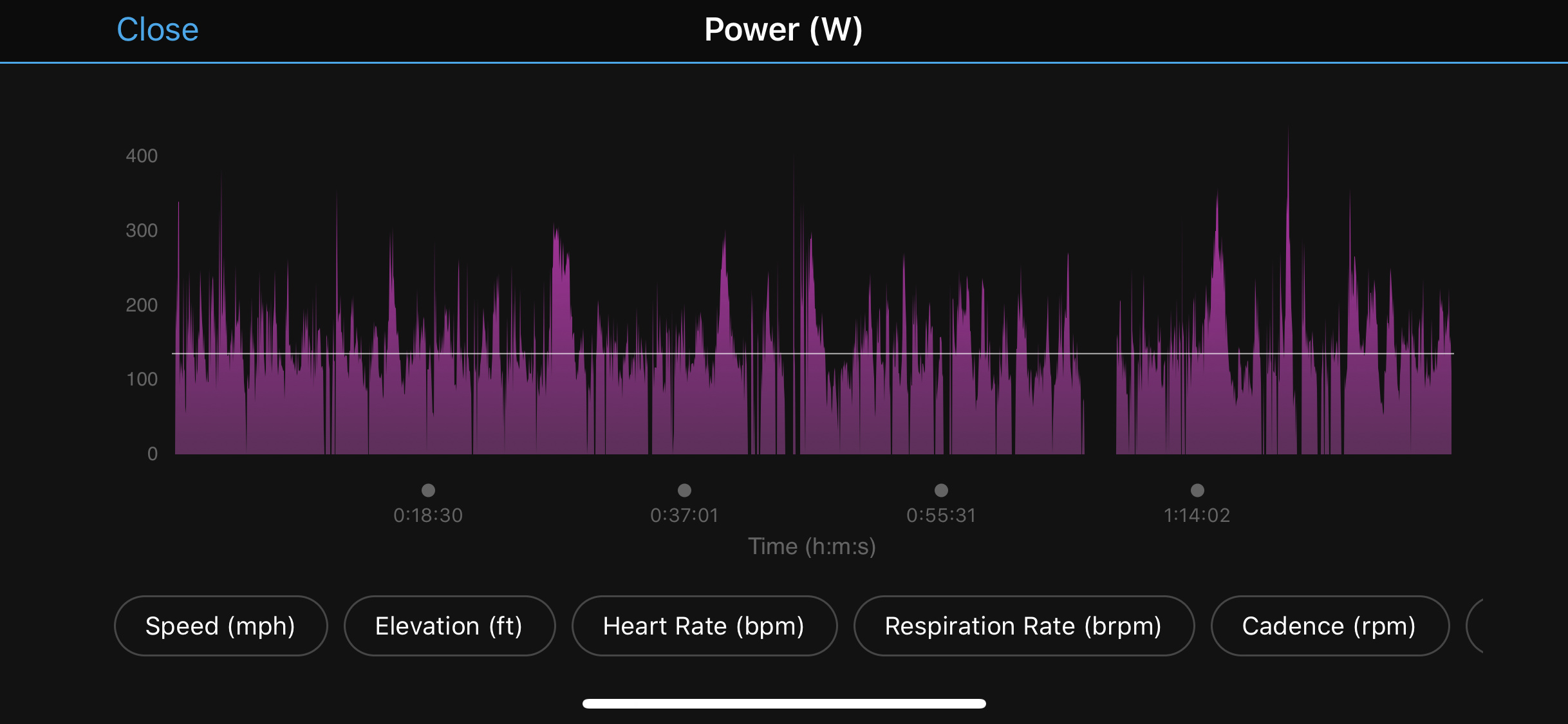

Here are some charts (in case it helps):
On Wednesday, I did Carson (TSS 67). Today, I’m scheduled to do Tunemah (TSS 103). Saturday, I’m supposed to do Leavitt +2 (TSS 96) but was thinking of going on a longer outside ride (~35 miles / 2.5ish hours). Sunday and Wednesday are my off days on TR.
Should I just do Tunemah today or would I be better off “recovering?” Also, if I ride outside Saturday, should I move Leavitt +2 to Sunday or just skip it?
Is doing these “unstructured” outside rides hurting my ability to realize TR gains? The TSS numbers are always higher than the TR TSS workout numbers, but there is no structure to how I’m getting there.

The next thing is that outside ride you referenced. You’ve got an IF of .98 -that should be a very hard ride. Did you feel like you went out & hammered about as hard as you could for 1.5 hours? That seems unlikely to me & something is off here. Most likely, your outside ftp is a good bit higher than your indoor ftp. I just put a power meter on my mtb & on my first ride, based on my indoor ftp of 225 ish, the IF was well over 1 for roughly an hour ride. Based on how hard I felt I went, I manually entered the ftp for that ride in TR & it gave me more appropriate TSS/IF. I’ve been using that number for my outside ride ftp & think I’m pretty darn close to where it should be which is about 12% higher than what I can do inside. Going to test soon but weather has been spotty here & im riding for fun outside when I can.

I don’t know enough to know the answer to this. I will say that I felt like I was going hard the vast majority of the time (just trying to keep up with the rider referenced above). Average heart rate was 88% of max.

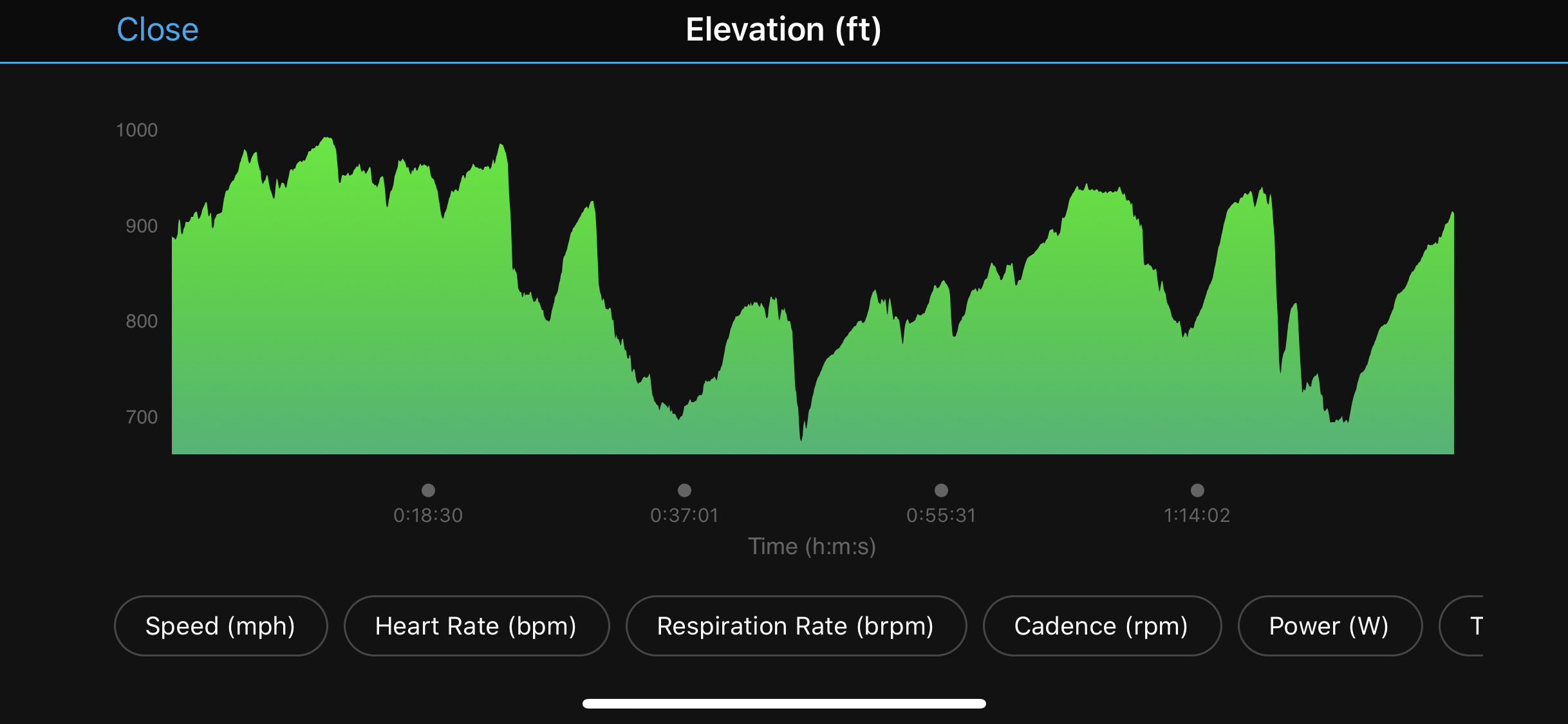

Also, if it helps, here is the elevation profile of the ride.

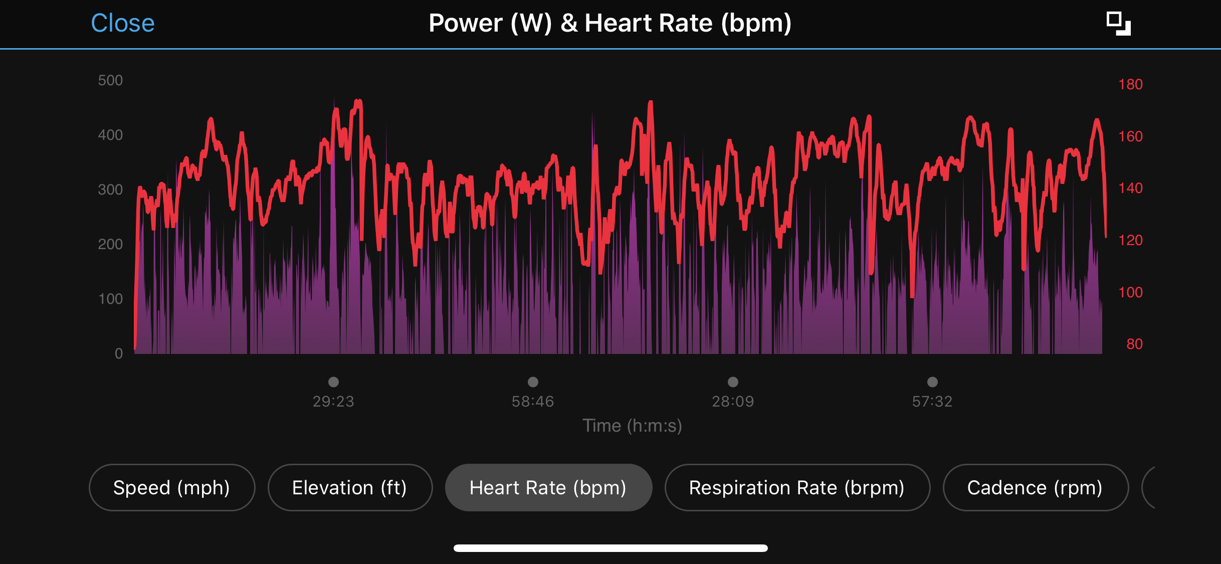

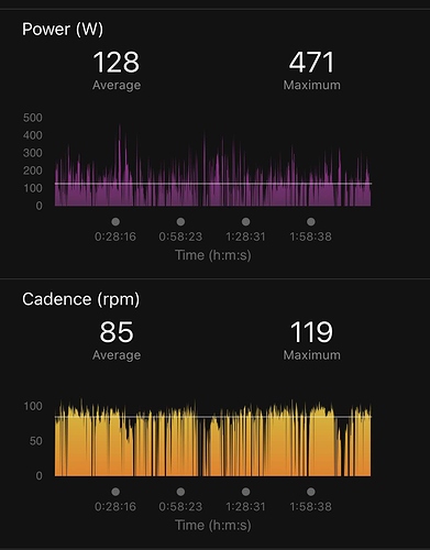

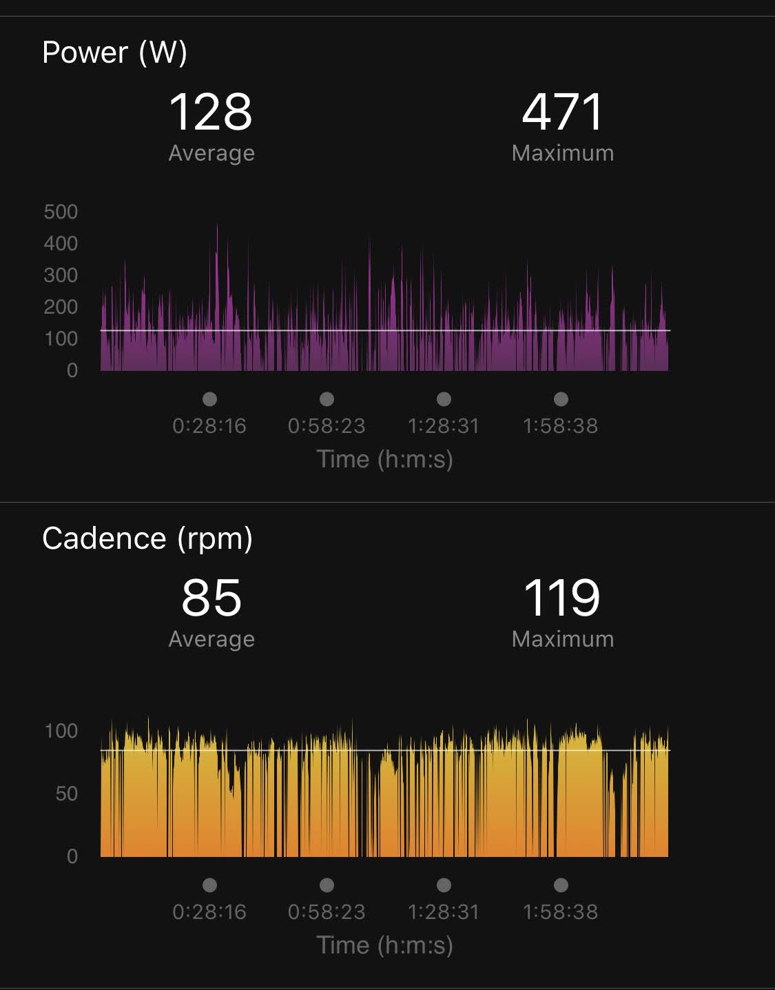

Here are some pics from the Saturday ride outside (it’s a single-sided power meter, so you can disregard those numbers):
The answer seems to be to either switch from MV to LV or to make some decisions on riding outside less.
Show the HR vs power pics.
Of course.
Yeah, looks like you’re going to have to just shift into lower gears and slow your cadence to match your target power.

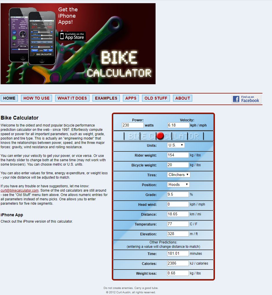

Bikecalculator.com gives an answer of at least 9.5% when presented with this data (assuming worst case on most factors):
I’d second the suggestion to change gearing if this is the case, but if 10% is the biggest gradient you encounter I’d just change cadence - 34-28 at 60 cadence is 5.7 mph**, at 50 cadence it’s 4.7. 50 is a reasonable cadence when standing and referring back to bikecalculator, that pace requires 175w.
