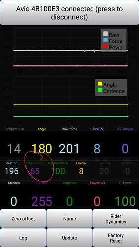

Have you seen the troubleshooting video? I went through some of the steps to check mine was ok, all looks correct although my calibration number is outside of their indicated range

First time poster here - my crank is going back to Avio as on my first trial after receiving my crank back I saw the watts about 20-30% lower than my Tacx Neo and even when stationary the force number was jumping around all over the place. I did a fresh 10KG calibration, which improved things, but still get a weird inconsistent output. The crank is going back for recalibration - I am not sure I hold much hope though.
Apparently some variation is normal, see 1.48 on this video. was yours moving around much more than that?
Mine should be back in a few days so I’ll run some more tests then.
Mine was generally at -10 but also jumped to -99. i will go through the troubleshooting video tonight step by step - record a few logs and keep a close look at all the figures. I see the log file has a field called ‘PowerModifier’ I assume there is a hidden setting somewhere where I can change that to bring the power up to expected levels, but I don’t think it will fix my 3 second average power that jumps around 30 watts at a time despite smooth pedaling and no real change in Zwift using my Neo simultaneously. I just hope that Avio can handle carbon BB30 cranks when re-calibrating.
