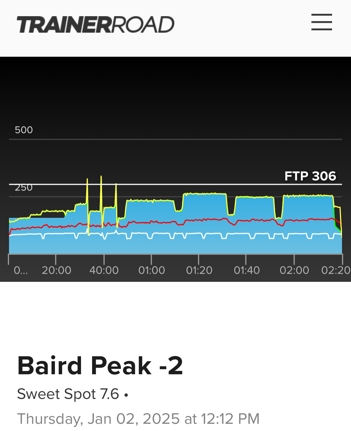

For the majority of the plan, I have been doing a long endurance workout on Saturday, instead of the sweet spot that should have been prescribed. Am I better off continuing what I was doing, or doing the sweet spot workout + some additional endurance afterwards? I can handle the training load, so I am just looking for the best option regarding performance improvements.
What I do and recommend is switch your Thursday and Saturday workouts. Then change Thursdays closer to tempo such as below. Add additional z2 after if needed.
