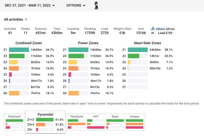

I guess then that goes on to confirm my suspicion of my doubt about me working efficiently through my time on TR and what I’ve been getting out of the recent VO2/Anaerobic sessions has not been what I’ve expected.
I then think that this image would show that while I have been putting in the work and feel fitter/stronger, I’ve not done any major work to improve my Cardiovascular system like I’d hoped I would have.
Without the individual knowledge of knowing how to manipulate AT to subscribe better workouts, choosing better alternatives yourself, or some of the workouts maybe not being as tailor made for everybody and the Zones they’re supposed to be working, does this beg the question of how truly effective AT is??
