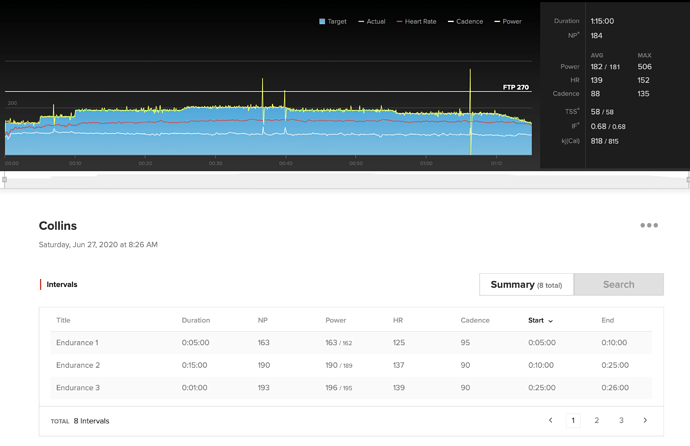

had my first ride with Erg Mode Power Smoothing OFF, on the Wahoo App, and using a Kickr Core.
What I noticed was:
With it ON
  • Much straighter power line (yellow one) and also much less shift in power output
  • Almost immediate clamping down of the resistance unit, so the Kickr wouldn’t allow me to fluctuate much from the target output. Perfect for long SS and TH workouts, but really crappy for Spanish Needle, for example.
With it OFF
  • Power graph and output was much less consistent, a little more as you’d expect to be riding outdoors.
  • Power adjustments were delayed, i.e. the higher the cadence, the higher the power output, until then the resistance unit adjusted. But it was a more gradual adjustment it seems. Seems perfect for sprint/bursts efforts.
In both, the interval target power was met. The OFF setting just made it maybe a little more natural. But I am curious to better understand this setting.
Additionally, I have power smoothing at 3 seconds (which I believe is irrelevant in this conversation).
Is my understanding of this difference consistent with what other Wahoo users have experience?
Below are two screen shots to show difference. You can see the OFF Version also has a spike of power, which the Kickr/TR app allowed me to do because it didn’t clamp down hard as soon as I increased my cadence.
Setting OFF:
Setting On:
Cheers! Ride On!
Understood. Very powerful mind game if it’s only psychological. Thanks for the info and I’ll do some additional research.
Am curious though in that with the setting ON I was never able to go over (aside from a few watts) the prescribed target output. With it OFF, I was able to significantly increase the power, which then also adjusted to the prescribed target. Wouldn’t that quick spin up help in quick bursts intervals, rather than the “clamping down” which I’ve felt in the past, and therefore, as suggested, it is not recommended to do Spanish Needle in full Erg.
Will continue the research, thanks for the input.

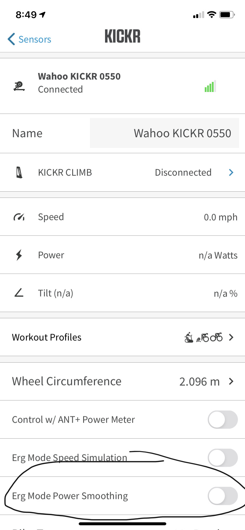

How do you turn off power smoothing?
Its somewhere in the Wahoo app.
Go to the Wahoo app, then Sensors, select your trainer and you should see it at the bottom:
Thank you sir

Hey @Giorgio_Orlandi, was the straight line with power smoothing turned on with the TR app only and off with the Wahoo app? Or the reverse? Mine used to match perfectly, but this season it’s been choppy (not sure if this was from a Wahoo firmware update). Thanks!
FWIW, here’s a 20-minute test with erg mode smoothing disabled on the Kickr via the Wahoo app, no changes to the TR settings. It’s a little more choppy (obviously) but matched the PM much more closely (as expected). Just to clarify, turning off erg mode power smoothing on the train does not change anything about how the trainer matches power in erg mode, just how much smoothing is applied before broadcasting the data.
Versus Byers Peak which had erg mode power smoothing enabled.
Hi, I have to be honest, I can’t remember right now as I’ve been off the trainer for several months. But I can tell you that after writing here I learned that it was merely a graphical representation. In the end, the Watts were always as prescribed by the TR workout. I think there is a good Lama video on it that should be in this thread.
