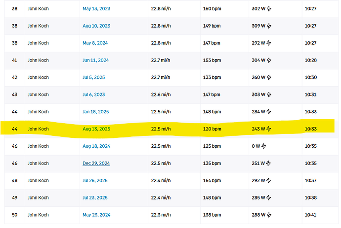

I found this thread pretty interesting. I always thought that I was making an effort to be sort of aero, and wasn’t capable of it. I didn’t care that much because I’m an MTBer and just use my road bike for training, but of course it’s fun to compare segment times and see how you improve. I needed to keep my ride super easy today, wanted something to focus on, so I was thinking back to this thread and decided I’d try my best to spend as much time as possible either in the aero hoods or in the drops. My default position is on the hoods with my arms close to locked out and elbows flared somewhat.
I looked at a segment I’ve done hundreds of times, figured maybe I’d save 10 - 15 watts, but the difference is HUGE. The other outlier, 12/29/24 I must have had a tailwind. My average speed for the entire activity was slower and average power ~10% higher.
The thing is, it made my ride less enjoyable. Maybe if I keep practicing it will feel more comfortable and natural, but I don’t know if it’s worth the bother.
