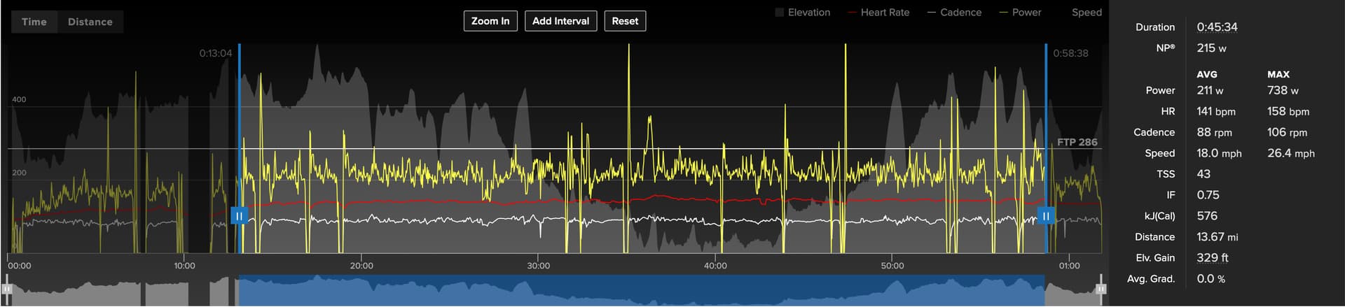

Sure, I could start running different tires, but then I’d not have a bike equipped to do the riding I like to do. Here’s an endurance ride from today. No headwind or tailwind, pan flat. Only 18 mph average @ 211w. I’m just a big wind block.
A big saddle to bar drop doesn’t always translate to a more aerodynamic position. You don’t want to be sitting totally upright, but you don’t need to have your chin on the stem. Try focusing on getting narrower rather than lower and you might be surprised. Consider trying some narrower bars or just pulling in your elbows in an exaggerated way can often make a big difference. Elbows out is great for protecting your position in a tight group, generally terrible for aerodynamics.
