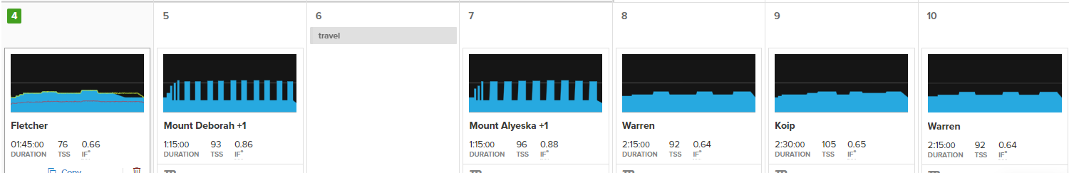

I just finished a three week break and started back in with this last week
This week and the following week aren’t ideal due to some travel considerations, but the are as follows
If time permits I will extend all of the weekend workouts, hopefully into the 3-4 hour range, but depends on life.
If I respond well to a block like this I will build out a similar four week one to cover the rest of November and December. If I don’t respond well then I will re-evaluate and try something different - either SSBMV with adding substantial endurance time to the end of every workout or pure TB.
Mostly curious how I do with a polarized approach, but also experimenting a bit with fasted rides (only on the easy stuff) to see if I can get some efficiencies towards the end of 3-4 hour road races.

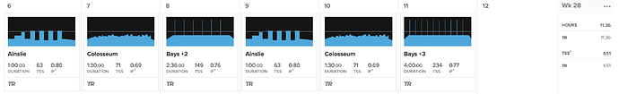

Here is my last week – one “sweet spot” session on Sunday, that got sabotaged by a sidewall cut.
Duration 14:24:39
12000 kj
TSS: 708
Ramp for the week: 0 (the flat tire botched a +1 ramp for the week*)
Time/TSS:
Mon 1:50:56 95 TSS
Tue 1:51:50 100 TSS
Wed 2:00:04 95 TSS
Thurs 1:45:01 86 TSS (weight training after)
Fri 1:33:38 92 TSS
Sat 4:00:54 166 TSS
Sun :53:24 63 TSS (tire blew); :28:55 10 TSS (nursing the patch home) (30min 400cal row and weight training after)
I’m going to aim for 15 hours, and 750 TSS this week. Trying to ramp slowly as I’m at 100 CTL right now (down from a 122 peak in Sept). Available time and limiting intensity means that I probably won’t be doing 800 TSS+ weeks any time soon. Next season starts in mid-Feb 2020.

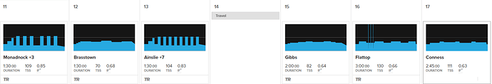

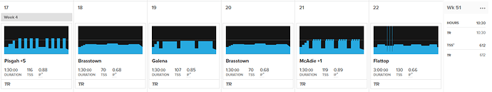

I’ve finished Trad Base 1 and 2, and am in the middle of 10 days continuous travel. Coming back from the road I’m doing a vo2 block that looks like that, with a focus on progressing out to 15-20 minutes time in zone (vo2 is a weakness). And then re-evaluate at end, and continue with either another vo2 block or start SSB to work on strength endurance.
I’ve never had an issue with strength endurance (has been a strength), although I must say I’ve always trained a significant amount of sweet spot. I’m curious how blocks such as the ones we’re both looking at will impact that but don’t have a great way to test it out. Maybe I’ll try mixing in longer threshold intervals if I do a second block
Again, this may backfire, but my first Base block is going to me modeled after how Jack Daniels would train an 800-1600m runner.
  1. Two “sweet spot” days of 2 x 20 fartleks --20-minute efforts of :30 @ 125%, 2:00 @ 75% FTP by 5 min. Should normalize to 90% for the interval. Muscular endurance is my strength – short efforts are my weakness. Also, Daniels would train “repetition pace” – a little speed – before going to sustained sub-threshold. I’ll give it a go.
  2. One long day of 4 hrs+
  3. everything else just turning over at ~60% to do 1500kj or work and keep off the weight.

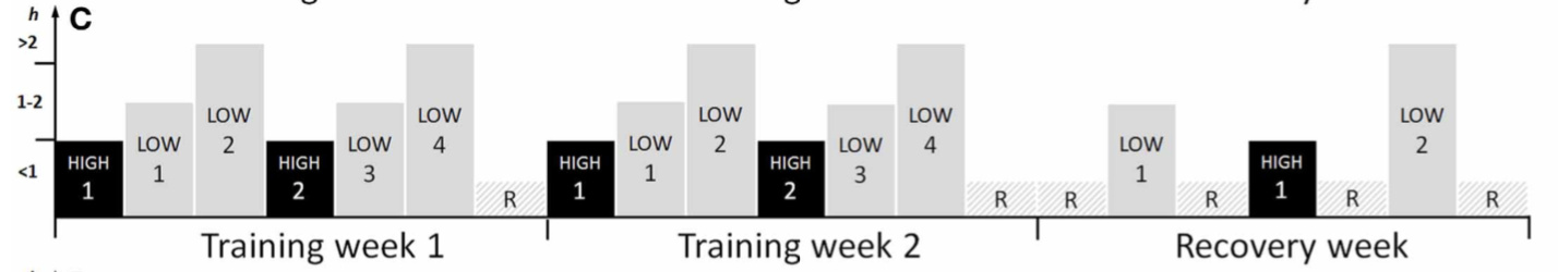

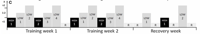

Regarding the impact of such a block, I started with Stoggel and Sperlich’s classic Polarized training has greater impact on key endurance variables than threshold, high intensity, or high volume training paper which has a polarized (POL) intervention that shows great promise compared to HIIT, Threshold, and High-Volume (LSD). The POL 9-week intervention was as follows:

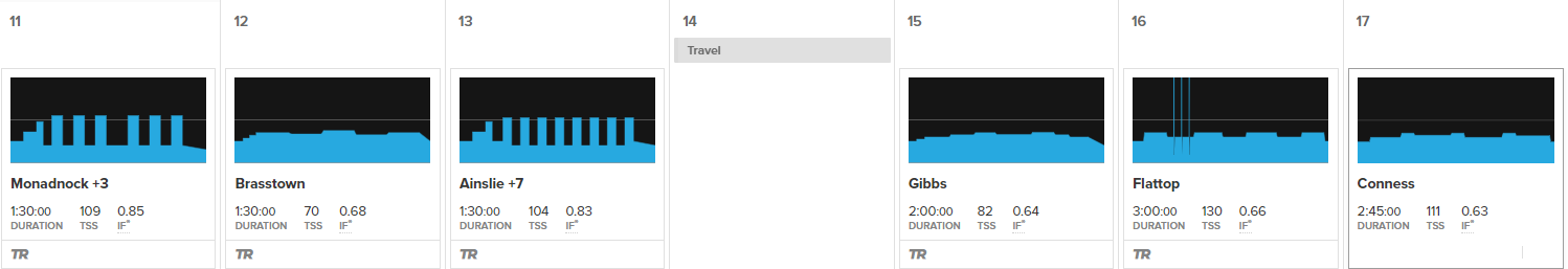

and moving that into TrainerRoad basically looks like this for the two work weeks:
and resulted in:
"The main findings were that (1) POL led to the greatest improvement in VO2peak, TTE and V/Ppeak; (2) V/P4 increased after POL and HIIT; (3) no significant differences in work economy were observed pre to post between any of the groups; and finally (4) body mass decreased by 3.7% in response to HIIT.
For the beginning of my block I’ve departed from the 4x4-min vo2 (90-95% HRpeak) used in the study, and likely won’t have enough time to do all the hours. The wattkg website has plans alternating between short vo2 work (30/15s) one week, and long vo2 work (4x6-min progressing to 4x8-min) the second week. So I’ve thought about doing the same. I’m going to adjust by feel.
To my eyes, I see this as a natural “raise oxygen uptake (vo2) to increase FTP headroom for SS strength endurance” bridge. Thats why I’m sandwiching between trad base 1 & 2, and sweet spot base. And although its in the context of Ironman training, Dan Lorang the head coach of Bora Hansgrohe uses a vo2 block before strength endurance. Time will tell.

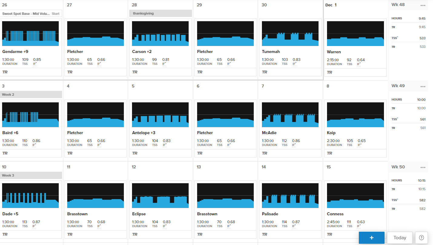

I was thinking about trying to do something close to what you made after in done with SSB
I prefer to think of it as an “aerobic booster block” (and not polarized). This fall I’ve completed traditional base (TB) 1 and 2, and at the end of TB2 was just starting to feel better overall “aerobic fitness” including lactate clearance (easier to push the pedals hard). So this aerobic booster block is hopefully going to keep picking up benefits of aerobic base workouts, while starting to increase oxygen uptake with intervals that are designed to increase maximum aerobic capacity. I’m predicting that will give me some additional headroom to grow FTP during sweet spot base. That is the theory, like I said it is an experiment.
After this aerobic work, I’m going to do TR’s SSB1 and SSB2 to work on pushing the pedals hard (muscular strength endurance). After that I’m planning to do TR’s short power build and modify to do outside with more max efforts (to build FRC).

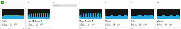

@trpnhntr how’s it coming along? I’m about to start this Stoggel and Sperlich inspired block:
to get started I ratched down intensity on easy days - Townsend instead of Colosseum/Baxter, and Bays +2 is now at 65% instead of 75%. Decided to go with the 4x4-min intervals in the paper.
I really enjoyed the three week block I built out. It was nice to be able to focus strictly on two hard days a week - mentally and physically.
I am having a hard time evaluating the efficacy right now as I’ve just started my fourth week (a recovery week) and was starting this block after three weeks off. Overall I’ve increased my FTP 12 watts during the three weeks but I can’t say if that’s just rebounding from the time off or due to the approach
I’ve put together my next block similar to the last one - but there are some changes. I’m now doing VO2 Tuesday, Sweet Spot Thursday, Threshold Saturday, and endurance Wednesday, Friday, Sunday. I think adding some increasing duration sweet spot should be sustainable and should get my muscular endurance moving again.
Block is actually four weeks on/one week off because I have a two week vacation starting at Christmas so want to be pretty deep in the hole by then. The four weeks looks like this
