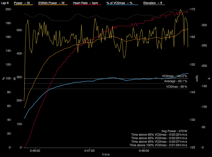

Here’s a 3m interval I did. It looks pretty good:
01
Here’s the analysis showing that I really only get 95% of the WKO4 metric, which Tim Cusick says is the good stuff that you really want to elicit adaptation:
(see percentages in bottom right of screen: Time above 95% = 2m7s)
So, I think circling back, make sure you’re going hard enough, and maybe even reduce the time sometimes as opposed to the intensity.
