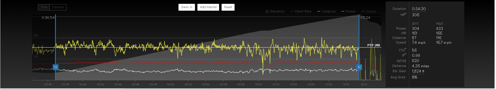

My freshest days are on Monday and Friday because I don’t ride on Sunday and Thursday. The 32-min effort this year was done on a Saturday at the end of a 3 week build (before recovery week). Mon-Wed block was ~6 hours and 350 TSS, with Monday as 6x45-sec(30-sec off) max effort sprints sandwiched between 15 min tempo efforts, Two-and-a-half Hour Tuesday endurance (74%), and 3x8-min at 94%. CTL at the time was low 60s, which is enough base training load for me to really hit my stride on training efforts.
After that Mon-Wed block of work, I had two days off with unusual Friday off due to wind/allergies. After those 2 days off I was ready to slay my scheduled shorter threshold workout, using 275 estimate from the earlier 290W “what I perceive my 20-min test pacing to be” results. Out on the road I felt so good that I kept it going for 32 minutes before running out of open road due to sunset. Having done enough of these efforts I could have pushed that out to at least 50 minutes.
