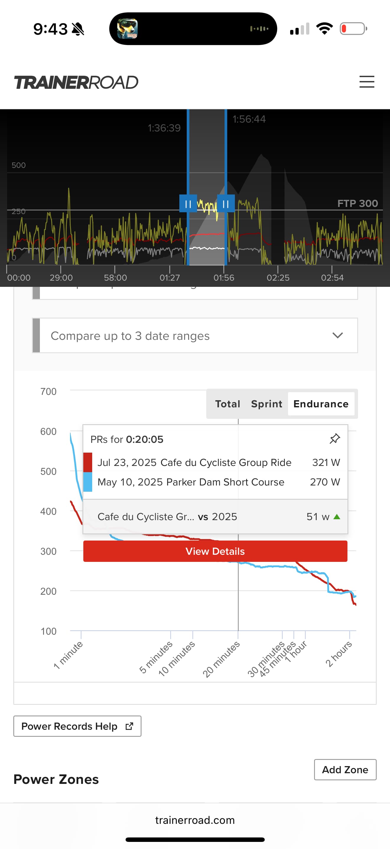

I feel quite confident that my current ftp of 300 is correct, if not a few watts low, so I saw no reason to accept TR’s suggestion of 284. I did 320w for 20’ in the middle of a ride recently, Intervals.icu was 306 based on that ride, I think TP was 305. Intervals.icu has even suggested some inflated values recently based on some shorter punchy efforts.

When did you do 320 for 20 minutes? I can’t find it in your calendar, and your best 20-minute power from 2025, according to your power records page, is 270. :face_with_monocle:
If that data isn’t getting into TR somehow, that could be why we’re not putting you at a higher FTP.

July 23rd. The ride is in there. (Cafe du Cycliste Group Ride)
Ahh, I see it now. Your custom season named “2025” in your Power Records was only looking at rides through May. :man_facepalming:
I think I might see what’s going on here. :light_bulb: Let me chat with an engineer and I’ll report back. :selfie:

Alright, @cmc274,
I’ve done some digging on my end, and it seems like I might have a good idea of what’s going on here. :light_bulb:
One big thing to note here that I didn’t notice before is that you’re using different power sources when outside vs inside. Normally, this isn’t a huge deal if they read power similarly, but what I’m noticing now is that you’re regularly doing higher power figures during outside rides, but struggling on some workouts when riding inside.
I’d be curious for you to use your two power sources simultaneously to see if there is a discrepancy between them and how big it is. :eyes:
