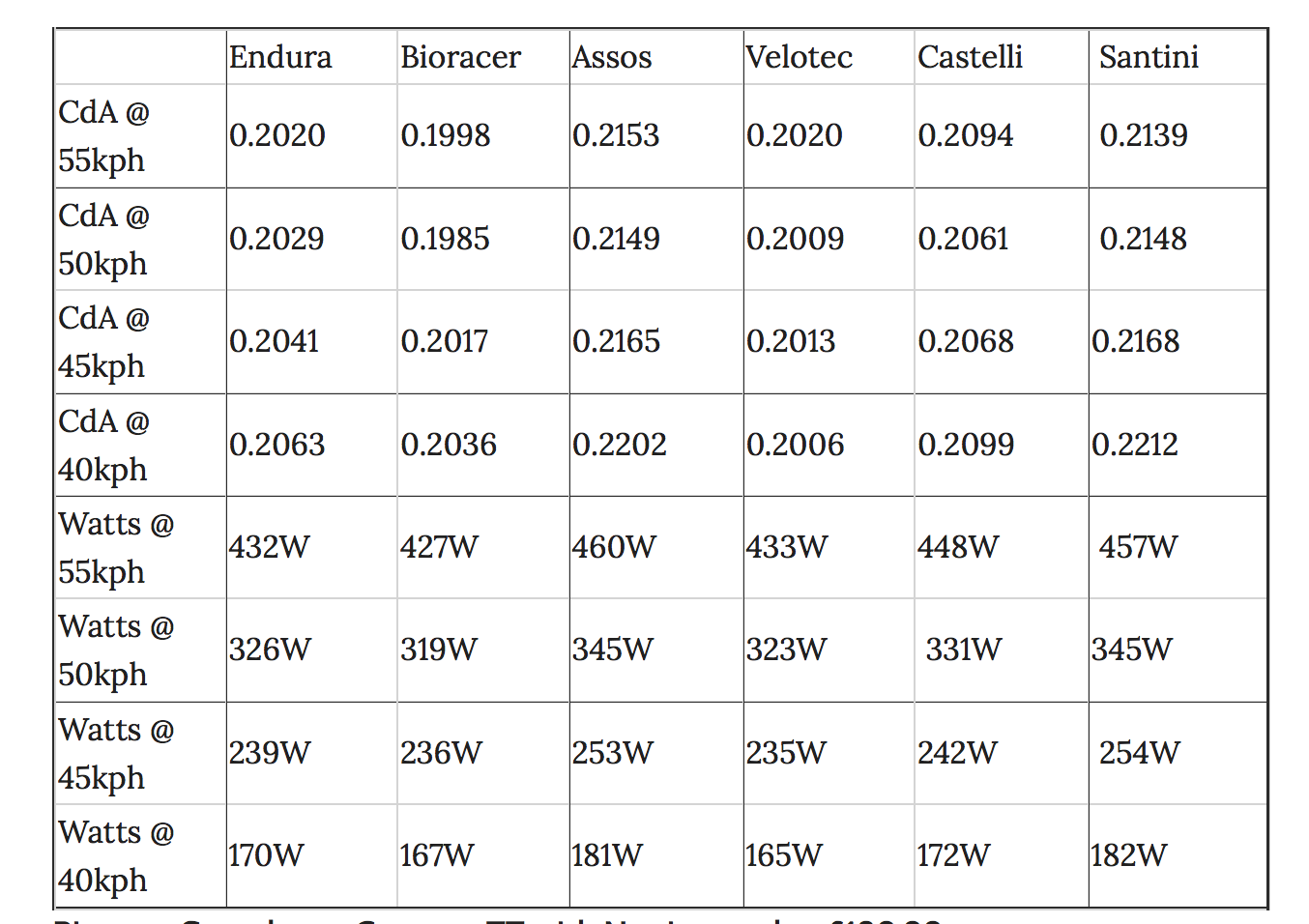

I’m going to pick up one of the Velotec suits based on this: The best skinsuits for cycling: Aero tested | Cycling Weekly
(hat tip to @KorbenDallas for mentioning it above)
Tough to beat for 100EUR: https://www.shop-velotec.cc/collections/summer-collection-race-fit/products/short-sleeve-pro-aero-speedsuit-with-pocket
That Velotec suit is a great deal.
I was a little surprised by the article, showing reasonable small differences between skin suit and jersey/shorts.

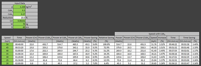

As promised here’s the table with Crr added.
I’ve chosen a 70 kg rider and Vittoria Corsa Speed with a Crr of 0.00231 (fast as).
Back calculating Velocity from power wasn’t as straight forward as I thought once you have two velocity terms, one of which is cubed… Wolfram Alpha to the rescue along with a bottle of Auchentoshan American Oak.
Equations
v = velocity, A = drag constant, B = rolling resistance constant, and P = power
Even taking into account the rolling resistance the drop in time saved is much lower than the drop in power saving, so I still think it’s more relevant to state time gains as a percentage of overall time.

Looks like % time saved is probably the best metric, followed by % power saved.
Savings expressed as absolute watts is not very helpful.
For your next assignment, what about adding in % grade :stuck_out_tongue_winking_eye:
Really helpful to see the analysis like this. Helps inform if it’s worth spending a lot of $ on aero gear.
I wrote down P = A x v^3 + B x v scratched my head and then promptly typed it into Wolfram Alpha…
Took a while to type it into excel. Again, numbers match the online calculator.
I agree with you assessment of the numbers.
Mike
So if I buy a skin suit that saves 20watts at 45kph, and ride at an average of 20kph on a MTB, I’ll save about 1.75% in time. So for 9 hrs on the bike at 20kph, I’d save 9.5 minutes with the skin suit. That a correct takeaway from your numbers?
