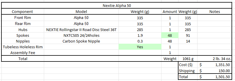

I’ve been discussing a 50/50 built at Nextie with @teddygram and this one would be 1.06KG, with no rim tape needed, and (as I understand it) internal nipples. 23mm internal, 30mm external.
Basically lighter than any mainstream climbing wheel with true aero depth. The weight weenie / lighter rider in me would like to see 20 spokes per wheel, but that isn’t available yet.

More technical details;
