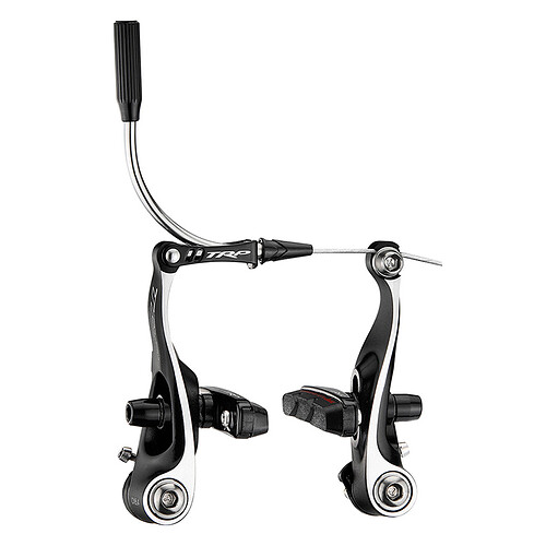

Third, the most powerful, and by most powerful, I mean still barely work compared to disc brakes, I’ve found are Avid Shorty Ultimates. People are basically giving away canti brakes now, so you should be able to pick up pretty cheap. These can be set up either wide, which is the same way your front brake is now, or narrow. The narrow stance gives you more stopping power. I’d replace at least the front with a shorty ultimate. I ran those TRP mini Vs, they stop well, but don’t have great modulation, and have very low mud clearance.
