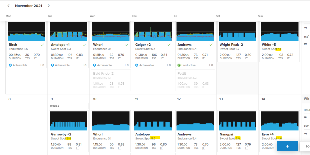

Dear TR forum,
Please refer me to the right thread if this is the wrong one for individual adaptive training questions, but my case may also interest others.
As you can see in this image my Sweet Spot progression is at level 6.5.
The Sweet Spot Base Training plan is not adapting the originally recommended workouts. I always have to go into replace workout in order to get something closer to my progression level. Wright Peak -2 for today was already changed manually by me.

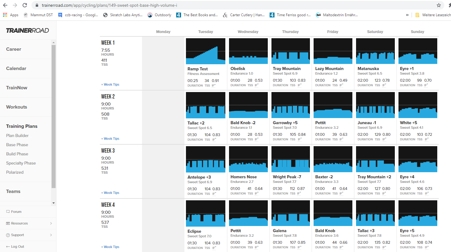

If I look at the Sweet Spot Base 1 Training plan it includes workouts that are more along the line of my progression level.
Why are the workouts not updating? When I was in the select beta group the app said: ā€œadaptions pendingā€ when it was going to recommend changes.
Lastly, if I replace the Wednesday and Friday rides with slightly longer recovery/base, is this taken into consideration?
Thanks
Hop on the Live Chat with support. They are super helpful and can possibly check AT is turned on properly or something? Looks like it’s not adapting at all, which might be some gremlin, or something innocuous.
When did you add your plan? Is it an individual phase, or via PB?
