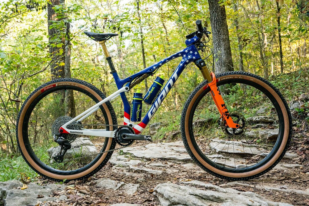

Weapon freshly washed and is ready to go. Going with the Schwalbe Rick’s front and rear.
11.3kg as pictured with pedals, cages and an insert in the rear.
