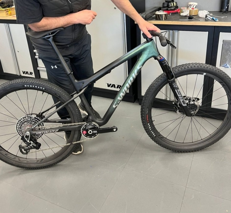

I haven’t had mine that long but have heard a ticking sound but I assumed it related to what I had in the SWAT box.
You said you removed the SWAT storage - did you take everything out and then ride and still hear it?
If it’s somewhat random (not tied to pedal stroke), I’d also look at the headset. I’ve found it pretty common for new bikes to get a little headset slop as the bearings sort themselves out. Even if it’s not the issue, it’s worth checking/adjusting the the headset after ~10 hours of riding on new bearings. In my opinion, it’s also worth putting a torque wrench on the bottom bracket and just go around the entire bike and check torque on everything (particularly on a new bike once it’s been ridden a bit).
I think I remember a lot of posts in the epic 8 thread on MTBR about an annoying click. It’s a long thread but might be worth digging through.
It looks I’ve found the possible issue:
Brake hose in the frame. I have to try this out.
It’s not from pedalling. Yesterday I’ve heard it when I just leaned the bike against the wall.
the break hose should be routed trough the intended channel. It doesn’t sit loose in the downtube if installed corretly. I’d also check if you haven’t gotten something stuck in the rear triangle behind the BB that’s rubbing/scratching against your frame.
Check the shock bolts too. Clean/regrease/torque.
Both times I’ve had any noise it was coming from that area.
It’s the brake hose inside the frame. Same issue as mentioned in the post from MTBR forum. I’ve put there a piece of foam and it fixed the issue.

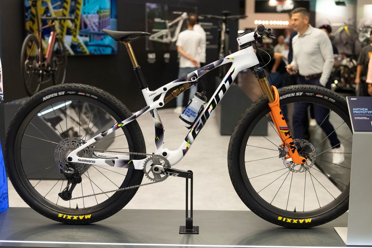

The new Giant Anthem looks interesting
My Epic build is effectively a Pro build. I have no complaints whatsoever. XX is virtually the same weight besides the crank which gives up 150g or so. Crank PM seems accurate enough for me.
exact same frame and travel other than fork on complete builds. the only difference is that low / high flip chip (geo not travel), Epic comes set default in high mode and Evo in low mode.
The pivot point being that far forward on the top tube is interesting, will be curious to hear what the rationale is for that. Other than that, it looks like every other modern XC bike. Not a criticism of Giant, not their fault that all designs have converged as single pivot flex stay built around 120 travel.
