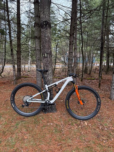

Finished up my epic 8 Sworks build and it is 19.82lbs without pedal or cages.
To head off critical commentary. I actually prefer when people report weights without cages and pedals because not everyone uses 2 bottle cages and not everyone uses the same pedal platform. I can reweigh with 2 sworks cages and xtr pedals if someone wants me to.
To head off commentary #2. Yes I ride without a dropper. I know it’s holding me back. Yes I probably suck at mountain biking. On the other hand I ride mainly endurance races with more time spent climbing or on the flats than descending. I’m not riding huge drops or feature. I learned to ride with no suspension which means I am too old to risk injury and I rode so much without a dropper that I don’t know how.

Nice build! This is mine.
Medium S-Works Epic Frame Matte Carbon Ride Wrapped
Flight Attendant with dual sided Quarq PM
SRAM Transmission with 10-52 Cassette and 34 tooth chainring (will downsize)
Darimo Carbon Seatpost
Roval Control Combo Bar and Stem (60mm)
Nextie Omega with Carbon Spokes and DT Swiss 180 Wheelset
Continental Dubinital 2.4 Race Compound
Berk Saddle
Trickstuff Piccola HD Brakes
No cages
No Pedals
