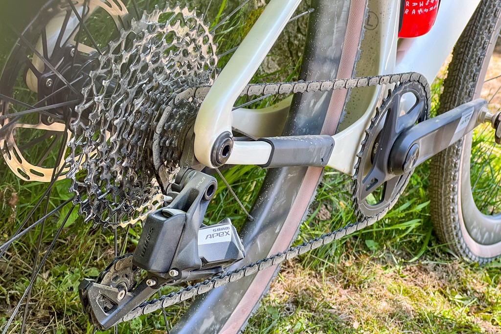

Bike shops getting ready to dump their current ‘entry level’ bikes before the new ones with Apex axs show up. Going to be great if you’re a buyer here pretty soon.
Escape Collective’s podcast made the interesting point that this further democratizes quality shifting. All the electronics, motor, battery, shifting logic etc. are shared across AXS, so Apex should basically shift identically to Red.
Re: Apex vs. Rival, the only functional difference (besides stamped vs. forged bits) is that Apex’s pulley wheels run on bushings, not bearings. Probably a couple-watt penalty, though not something the target consumer is likely to notice or care about.

I’m pretty sure one of the articles / releases said that Apex Wireless is 1x only and cannot be paired with a front derailleur. I’ll update this post if / when I find the reference.
EDIT:
SRAM says you cannot pair an Apex AXS rear derailleur with a 2x front derailleur of any type.
Yeah, sounds like you’d need to get a rival RD to pair to FD, but can still run apex shifters from what I’ve read. The RD is the system master for SRAM. I’m a bit surprised that the APEX RD doesn’t support the FD pairing. Might be to create some differentiation with Rival or might be that it’s programming/logic is based on eagle MTB RD’s (which could never pair to a FD).
That’s true for the rear derailleur. The parallelogram for 1x is different than 2x because of the different chain length requirements. Same reason none of the mountain groups can be used 2x.
The shifters should be fine (unless Sram artificially limits them via firmware, which seems unlikely). You’d need a Rival/Force/Red rear derailleur, in addition to the front.

Blips pair to the rear derailleur, and the Apex AXS RD is fully compatible with blips. In fact, @dcrainmaker’s loaner came with two blips.
Correct, totally compatible with wireless blips. But isn’t compatible with the older wired blips/clics (via the blip box).
I think you’re right. At least that’s what the YT reviews I watched about the blips said. You have to pair through a main shifter to the derailleur, but then you can just use the blips and derailleur on their own.
