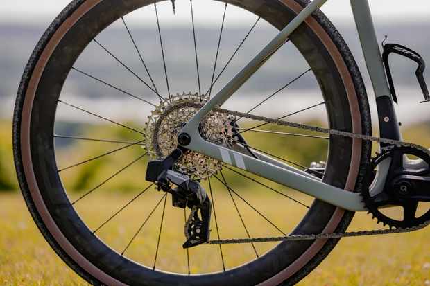

This is all fully cross-compatible with MTB or Road. There are 2 different Apex 12s derailleurs, one that can handle Eagle cassettes (for MTB/mullet setups) and one that works with road stuff. If you’re running MTB you need an Eagle chain, if you’re running the road version you need the Flattop chain. The only point of non-compatibility (as far as I can tell) is the chain, as Flattop/SRAM road uses different roller sizes. So you still can’t swap between MTB and road cassettes on the same bike. But cable pull and gear spacing are fully cross-compatible across the whole SRAM 12s ecosystem.
Partly true.
Apex AXS XPLR is compatible with the other XPLR road/gravel stuff. Flat-top chain, etc. But, you could use an AXS mountain rd with Eagle chain in a mullet config, if you wanted.
On Apex mech, there are two Apex rd - one for road, one for mountain. Same cable pull, one is just configured for the 44t XPLR cassette (w/ flat-top chain) and the other for 52t cassette (mountain cassette, Eagle chain). Both are basically modified GX rds - just with cable barrel added and cage/pulleys spec’ed for the correct chain and gear range.
Yup, just listened to the podcast linked above, and learned of the partial split on gears / chains. Interesting and confusing to a degree, but sounds like it still makes sense broadly speaking. Just have to look close for anyone wanting to mix stuff to make sure a specific combo plays nice.
If I’m reading the media right, there are 3 new Apex rds.
1 - Apex XPLR AXS wireless. Works with flat-top chain and XPLR cassettes (cross compatible with other road XPLR parts).
2 - AXS XPLR mechanical. Same as above, but cable instead of wireless.
3 - Apex Eagle mechanical Different pulleys for use with Eagle chain and mountain cassettes.
Additionally, the Apex XPLR AXS shifter can control Eagle AXS rd for mullet config (Eagle chain, mountain cassette).
The Apex mechanical lever will shift an Eagle mountain rd (GX, etc) just fine, but you won’t have a barrel adjuster (could use inline, but easier to use the Apex Eagle rd).
Actually according to James Huang’s writeup on Escape, there are two mechanical AND two AXS RDs. The AXS RDs are basically versions of either Rival or Eagle, for road or MTB cassettes respectively. The two different mechanical RDs are nearly identical, with only very subtle changes to pulley wheels. This is presumably to accommodate (or not) the Flattop chain.
Huh, I wonder why they felt they needed an Apex AXS Eagle Rd? That’s just a GX AXS in different paint, basically.
