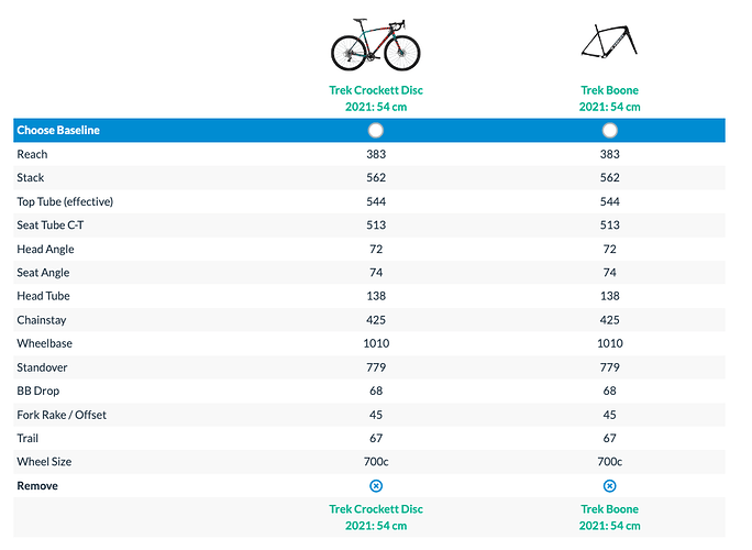

they’re not that similar? one is moulded from carbon, another is manufactured from aluminium tubes and hydroforms. same name, very different bike.
The only common across both is the fork, and some smaller frame part accessories.
What I meant is they are pretty much exactly the same geometry.
