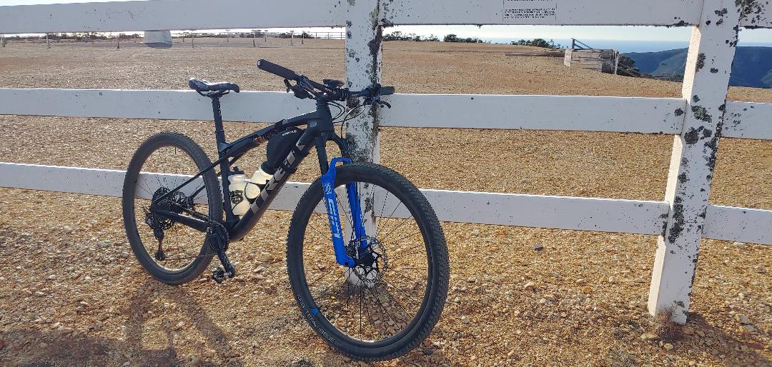

just want to chime in with my mostly very positive experience with this bike so far.
first things first, if you try to rationalize this bike ON PAPER, you’ll never get there. the usually-touted metrics of weight, travel amount, head angle, and cost, need to be taken holistically here. if you do that, you’ll find this bike easily punches above its weight (no pun) and is well more than the sum of its parts. it’s the underappreciated less quantifiable attributes that make this bike what it is.
RIGIDITY. this bike is STIFF. if you grab the back tire and move it side-to-side, you’ll notice it doesn’t move very much. i’d say it tracks AT LEAST as well as my Ripmo, and about 999% better than a bike like an Intense Sniper. i mean really whats the point of 100mm of travel if the wheel is going to flop all over the place when you try to use it. i really question this new crop of ultralight “down country” bikes with spindly rear ends and 115+mms of travel. its quality over quantity any day for me. and this bike delivers in spades. true it “should” weigh less than an Epic, but you know what? i’ll take that enduro-like rigidity in a 2kg package any day of the week in the real world.
EFFICIENCY. the bike doesn’t need a lockout. plain and simple. you can do uphill standing sprint intervals with the shock open and not miss a beat. it’s a rocketship. BUT, at the same time, there’s zero noticeable pedal kickback when seated, and the suspension proceeds to work seamlessly over the washboard stuff. it’s fairly difficult to bottom the bike out, but at the same time, the suspension works and you know it’s there.
LAYOUT. two bottles. in the triangle. enough said.
UPKEEP. i hate proprietary stuff too, but this really isn’t that. the damper assembly is just a shortened DPS with a different head on it. the strut will never wear out and the seal head and bushings in the frame that the strut slides on are serviceable off the shelf parts. there’s only one real pivot (by the BB) and everything else is up out of harms way and well sheltered from debris and dirt.
GEOMETRY and TUNE. This bike RIPS. It has no business being as good as it is. The rear damping is spot on. Plenty of low speed compression and more than enough high speed (which is a good thing at 60mm). the bike just goes. With the 69 deg head angle, its SUPER fun to throw into corners…it’s just so responsive. I’m so glad they didn’t follow the SLACK BRO fad with this thing. It descends fine and comes alive in the switchbacks and tighter corners. All in all, I’m extremely impressed with it. It truly is more than the sum of its parts.
build thread w/ pics here:
Great, detailed description. It’s hard to imagine 60mm being enough these days, but you have certainly intrigued me. It’d be cool to try out.
Your build is particularly nice, well done.
Thank you!
