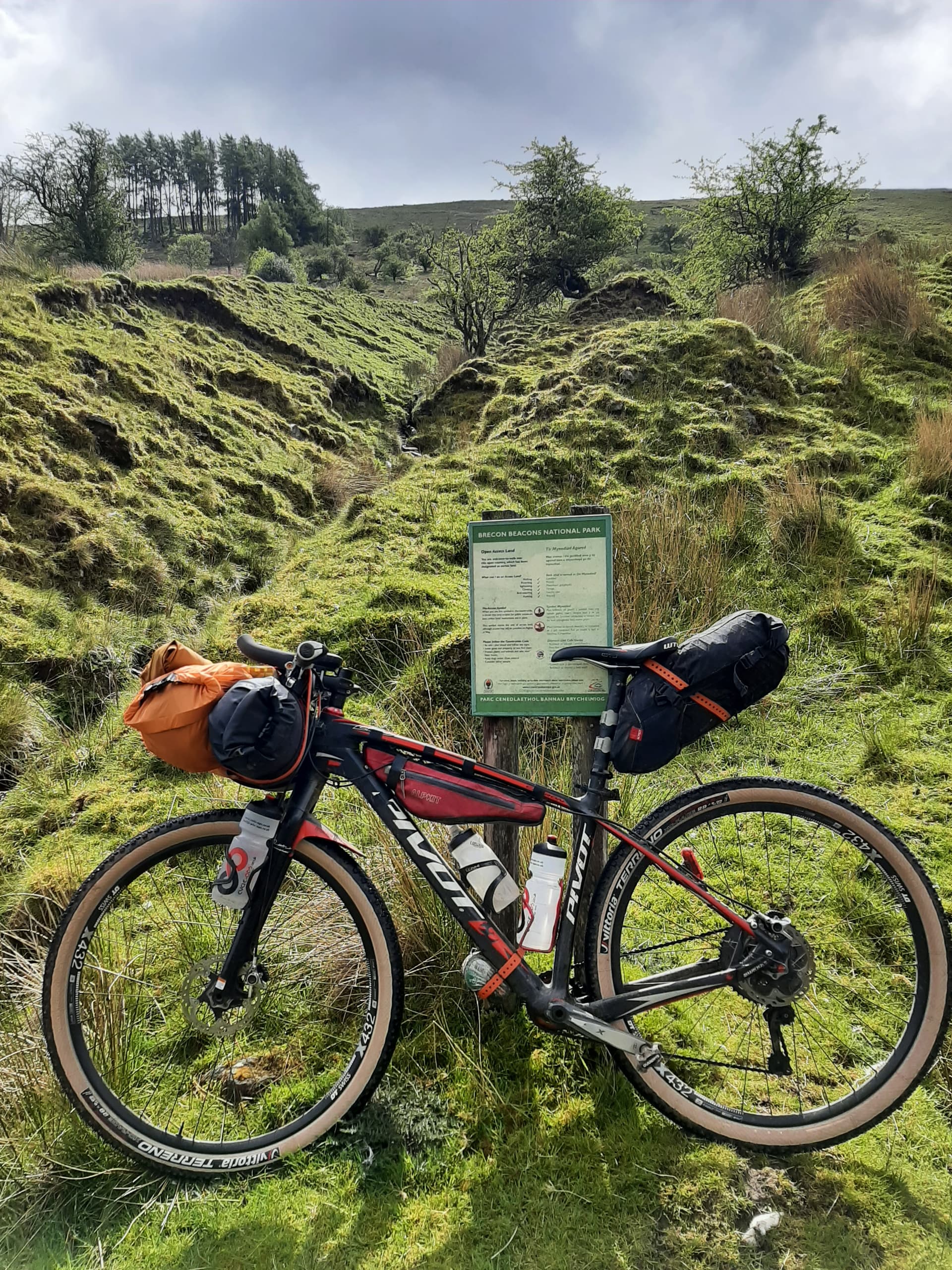

It was interesting this May when I did a 9 day bikepacking trip comprising of 8-13hr days at a very steady pace, then had two rest days before going to our cyclocross training evening. I was absolutely smoking everyone that night. It further confirmed my belief that fitness is fitness and race specificity is maybe not so important.
Although going up hills like this are never going to be z2 efforts :laughing:
Brecon Beacons, South Wales.
I rode from Sevenoaks in Kent to Bristol off-road using the North Downs Way, King Alfred’s Way then the Kennet and Avon canal towpath during the wettest May week in history I believe :sweat_smile:.
After that I did a three day road tour of the Beacons before returning home the same way.
It was utterly brilliant.
