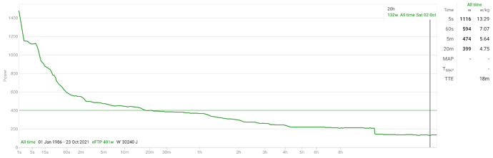

Only a few rides past that point, but hoping to do some “faster” 300k+ rides in the future. I feel like my legs feel the best (compared to others) after the 200km mark, so maybe I am built for some relatively long miles.
Some data points:
  • 1h = 366
  • 2h = 295
  • 3h = 259
  • 4h = 238
  • 8h = 210
  • 11:30 = 208

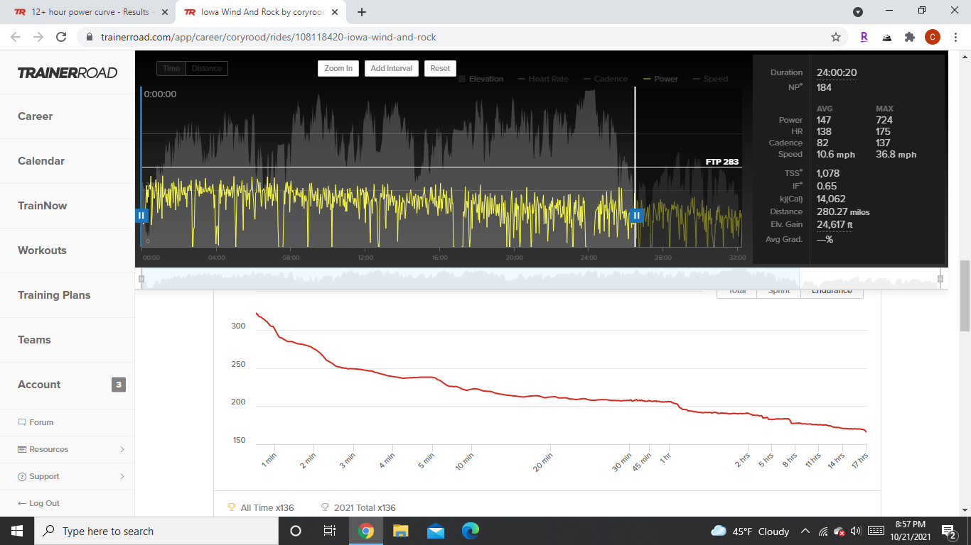

    And finally the only ride longer than that
147w Avg. 184w NP for 24 hours of moving time.(same event as my 12hr PR)

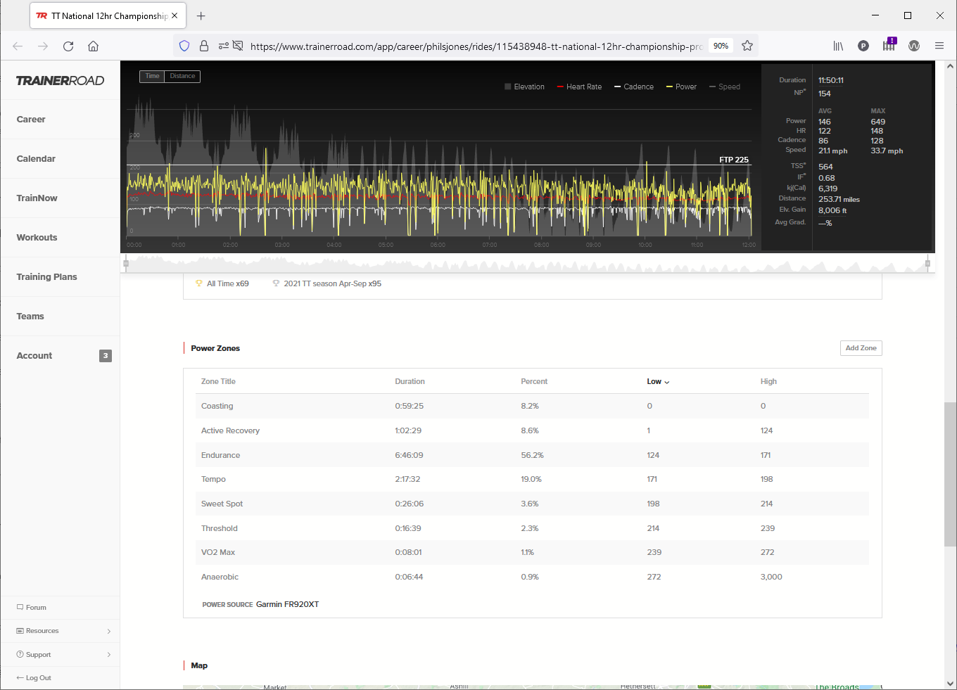

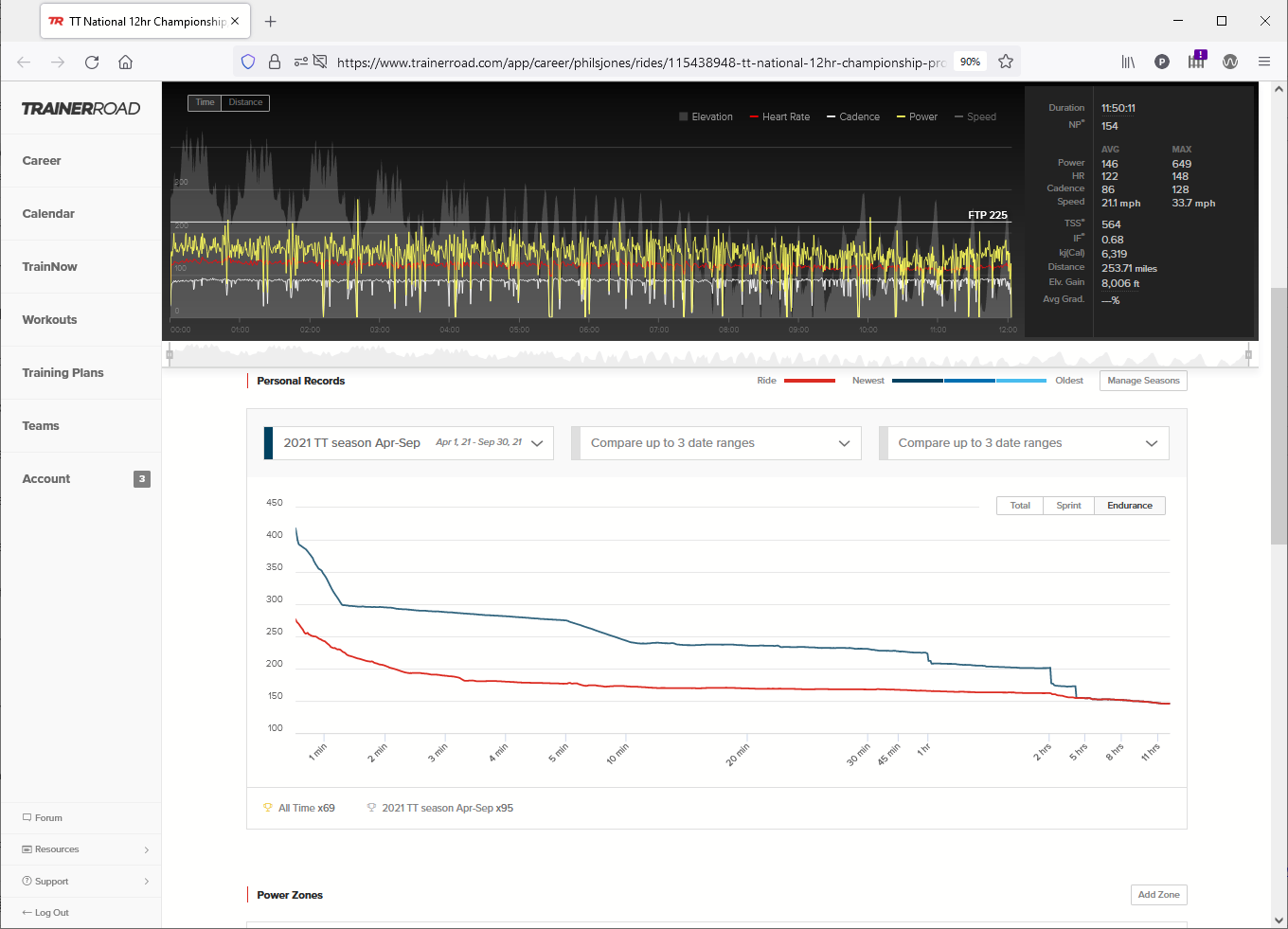

Not sure what original post’s question is. However, if it helps, I did a 12hr Time Trial a couple of months ago. 252miles, average speed 21mph, IF 0.68, off a 225w FTP. Average power 146. NP 154. That includes coasting for an hour down hills. I was stationery for 11 mins for food and pees. Do these graphs help the conversation?
I have no idea what my average over 24 hrs might be. Definitely I would be going slower/more econimically.
Graph with power curve, compared with racing season’s power curve (steps at 25m, 50m and 100m TTs of course)
Graph with zones. showing power in the 12hr TT
I did similar 12hr TT (236 miles) 2 years ago so may post that as well.

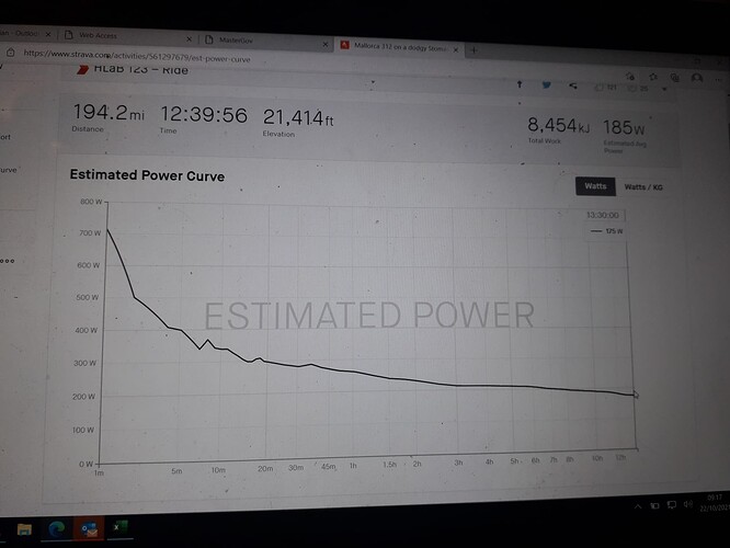

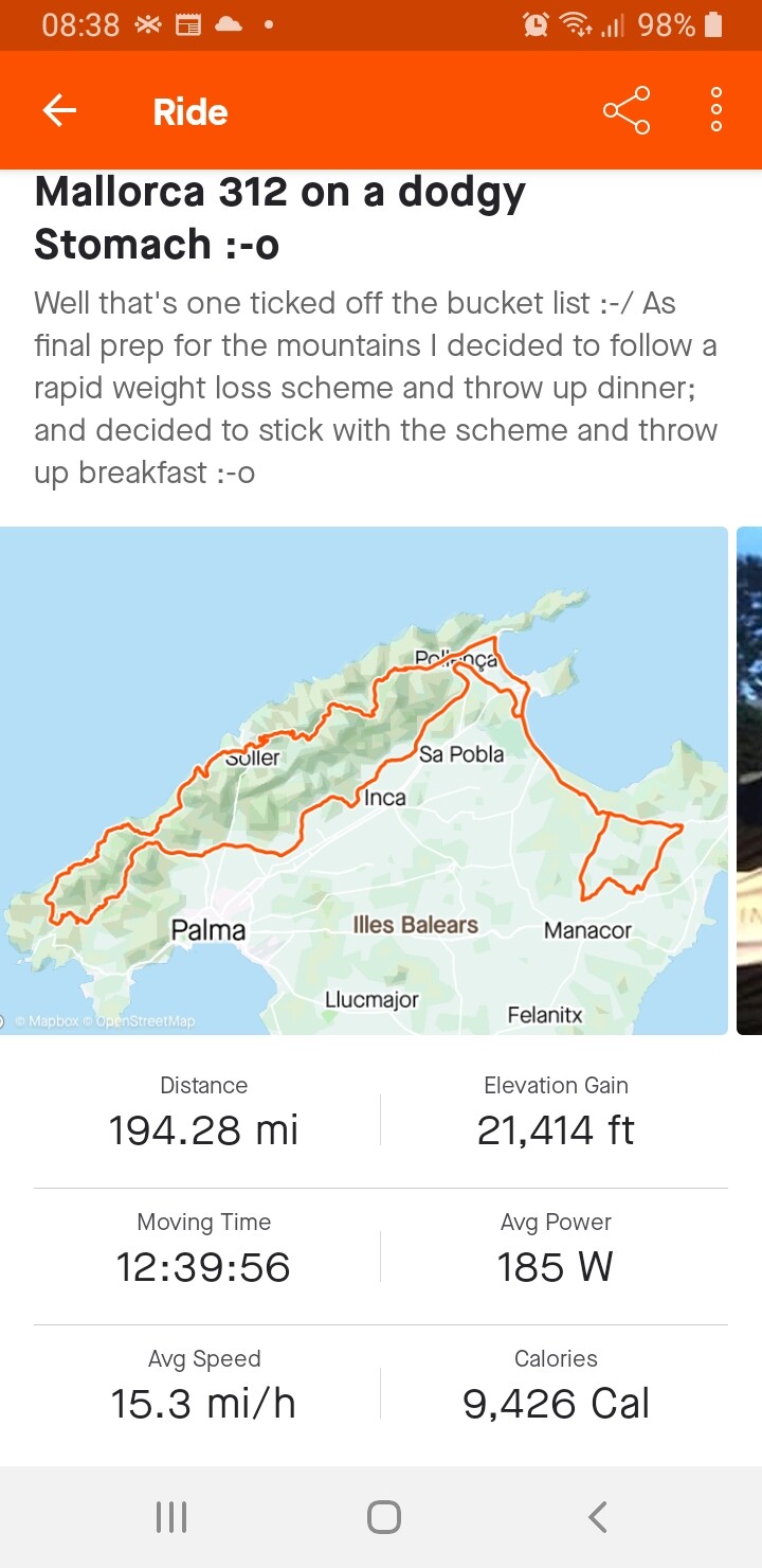

If Strava is to be believed (which probably isn’t :roll_eyes:) for the 12h40mins moving of the 312 I did 185w (or then 3.02w/kg) adding in the 50mins stopped it falls by the Strava calculation to 175w (then 2.98w/kg).

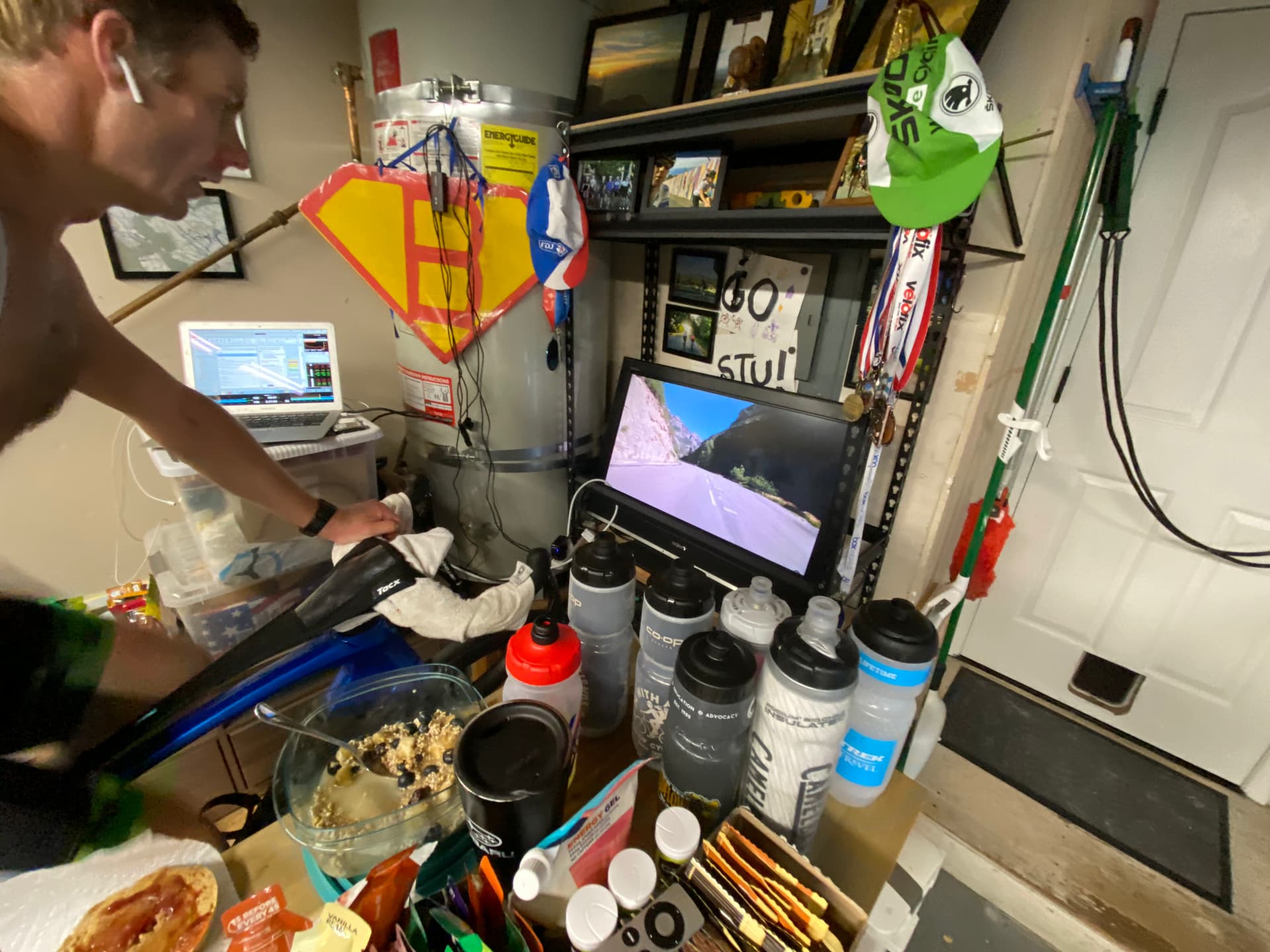

My wife hung up a thing in my pain cave that literally says, “You’re crazy” :joy:. It was height of covid, all my events were cancelled, and with WFH started doing longer indoor rides, and just eventually decided to see how long I could push it. I’d decided to do a 200 miler solo just to have something on my calendar, so it helped me gauge what I’d be able to do for that power wise.
Nice thing indoors is you don’t have to worry about where to store your nutrition.

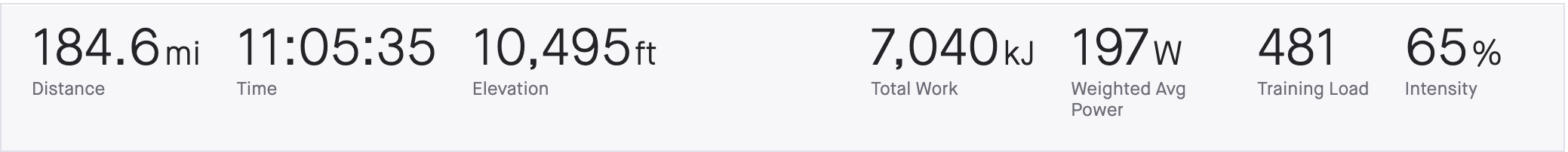

This was my longest ever, a road double century back in 2018.

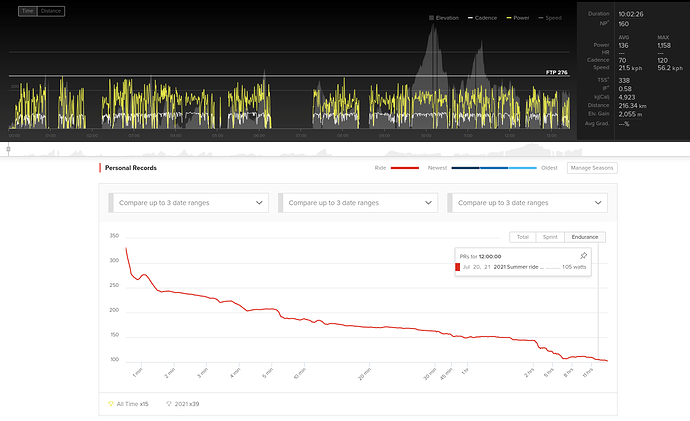

This year my summer solo bikepacking trip ended up being 1000km of pavement, gravel and a bit of singletrack across Finland over 5 days. All except first day had total elapsed ride time of >12 hours and power curve had power at ~100w@12h for each day and got a couple of >12h power PRs. FTP was ~276w (probably a couple of watts less)
Day 4 had the highest 12h effort at 105w.
Day 5 was longest at 103w@13h45min
Closest proper long ride effort has probably been “Saimaa Cycle Tour” event this year. 285km, 147W@10h15min. I wasn’t completely destroyed at the end and there was a lot of stupid pacing involved, so I’m pretty sure I could get similar power numbers for a full 12 hours with proper planning.
