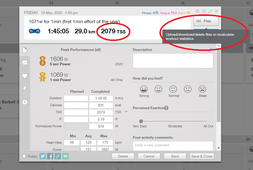

Unless I’m way off, to get 1000TSS/hr (to yield the 2000-3000 TSS for 2-3 hour rides screen shots) the OP would need a 4 digit FTP.
Impossible. In a very simple formula, TSS=IF x IF x duration (in hours) x 100. It’s not possible to go over 100 TSS/hr if you tested for an FTP properly regardless what the FTP is.
I agree. That’s why I posted. Just saying something is wicked not right and under reporting an FTP by 50-70-90 Watts doesn’t come close to accounting from the TSS. I used TSS=(secxNPxIF)/FTPx3600(100)…I was trying to get a TSS of 1000…
If his TP FTP is saved as 100w or so, then his intensity factor would be something like 3.0, which would then translate into the TSS figure?
Clearly Calum is not using TP TSS to estimate his training workload, but for analysing his data (better tool for it than Strava)
Pretty simple explanation, my FTP on TrainingPeaks is set to 100W. Reason being that doing so makes their workout creator very easy to use (power targets are based off of percentages of your FTP)

It’s probably a case of both. If your FTP is 100w and you’re riding at 300w for 3hrs you’d still be maxing out at 900 TSS.

It is not a case of both. I have opened the “1071w for 60sec” workout in TP, reset my FTP to what it actually is and then recalculated the ride for you. Screenshots of the process are attached. The TSS went from 2079 to 171.
Your wern’t taking into account the huge IF multiplier 1000w (and any other high power) gives you when calculating TSS if your FTP is set so low.
