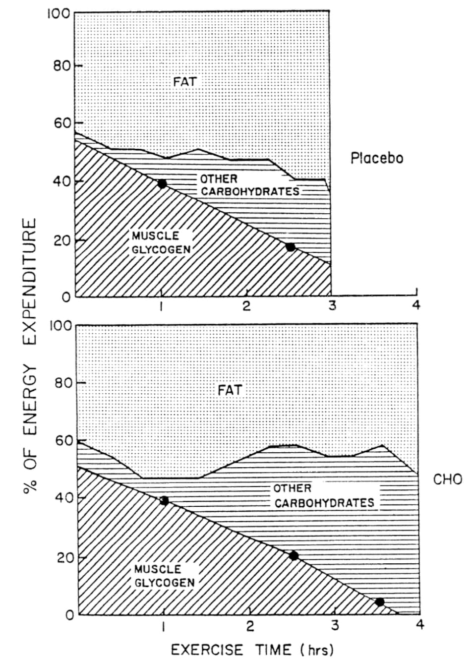

Additionally I’d recommend reading the study on “Muscle glycogen utilization during prolonged strenuous exercise when fed carbohydrate”
Some citation:
“…When fed carbohydrate, which maintained plasma glucose concentration (4.2-5.2 mM), the subjects exercised for an additional hour before fatiguing (4.02 t 0.33 h; P < 0.01) and maintained their initial R (i.e., 0.86) and rate of carbohydrate oxidation throughout exercise. The pattern of muscle glycogen utilization, however, was not different during the first 3 h of exercise with the placebo or the carbohydrate feedings. The additional hour of exercise per- formed when fed carbohydrate was accomplished with little reliance on muscle glycogen (i.e., 5 mmol GU kg-‘. h-l; NS) and without compromising carbohydrate oxidation. We conclude that when they are fed carbohydrate, highly trained endurance athletes are capable of oxidizing carbohydrate at relatively high rates from sources other than muscle glycogen during the latter stages of prolonged strenuous exercise and that this postpones fatigue…”
Thanks - great clear feedback!
There is so much in that study. Some of my takeaways:
  • the study suggests that feeding CHO does not spare muscle glycogen whereas in the end mentioning other studies that contradict that point. So still some confusion on that aspect :man_shrugging:
  • Feeding CHO does not flip a switch putting you into a stop using fat mode. In fact the picture above shows still big amount of energy used from fat even when fed CHO.
  • So even if higher fat oxidation rate when restricting CHO…if taking CHO you’d be able to go longer and so overcompensate overall fat utilized.
  • On the other hand…(and that supports the point you made):
  • But (for the bigger difference) note “from 80 min of exercise to fatigue”… that’s long into a hard exercise (I can’t imagine 70% VO2max for 3-4 hours (citing:“slightly below subjects’ blood lactate threshold”) :exploding_head::exploding_head:) … so it becomes a balancing act if you go down that path and need to keep upcoming training in mind…
