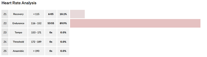

Tonight’s Z2 paced on power:
Resulted in these HR zones
