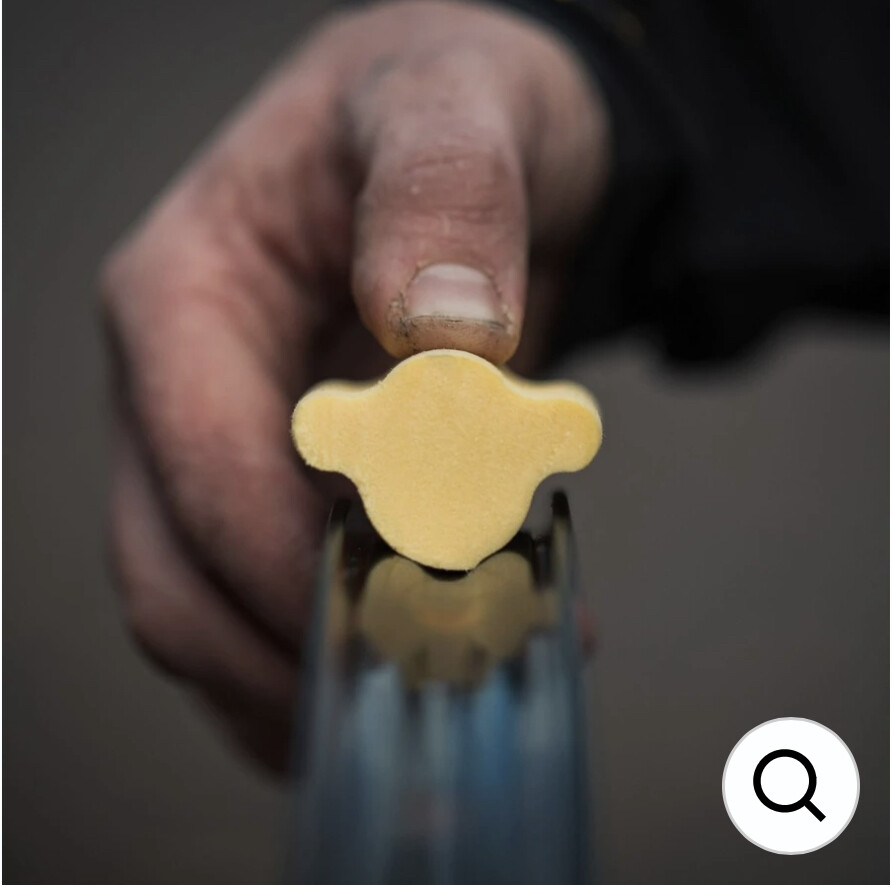

Assuming pressure is kept equal I can’t see how inserts would change anything with regards to rolling resistance.
Back in the day Jobst Brandt did a number of pretty thorough explainers on rolling resistance and argued that most of the losses weren’t from tread pattern but rather factors internal to the tire and rim/tire interface. A lot of his stuff is still kicking around ( Rolling resistance (Jobst Brandt)):
<<<The center ridge tire by Specialized was made under the belief that rolling resistance was kcaused mainly by tread scrubbing on the road and that reducing the contact patch would reduce rolling losses. In fact losses are mainly caused by rubber deformation in the tread, tube and the inter-ply rubber matrix, not by road contact. The raised center ridge increased all of these losses besides decreasing road contact, and therefore, traction when cornering or braking.>>>
Bottom line: casing flexing and tread “squirm” are major culprits—it’d be surprising if a tire insert didn’t have a similar negative impact.

I’m not saying you are wrong, but what makes you think inserts would cause more casing flex/tread squirm?
From JB:
Rolling resistance is caused by rubber deformation losses in the tread, the tube and the casing. The tube is firmly attached to the casing by inflation pressure so it is like a tread inside the tire. The whole tire flexes in three dimensional space, X, Y and Z. You can verify this typically by laying a standard business card between tire and tube. It will shred to fine confetti when ridden. It is this motion that causes hysteretic loss in the elastomer in the casing, the tread and the tube.
I read this to mean that since a good portion of RR comes from flexing and fretting between tread, tube, and casing then adding an additional interface (the insert) would yield even greater losses depending on volume, etc…
(Anyway, I’m by no means an expert—just wanted to point out that it’s not super-intuitive where exactly RR losses come from. At least to me. )
Just knowing where the internal losses come from would make you evaluate these different types of liners differently:
Fair enough thought. Though I’d say there is only a small amount of interface at the rim bead/side wall.
I’m also no expert, and that explanation does make sense with regards extra friction adding rr. It just doesn’t feel like my tyres roll slower with my insert in, and when visualising what you were talking about I was just thinking about the huge air gap between tread casing and insert. The sidewall definitely has some contact though.

Yes, I exclusively use Cushcore XC which is rim/lower sidewall contact, and a bunch of air gap.
