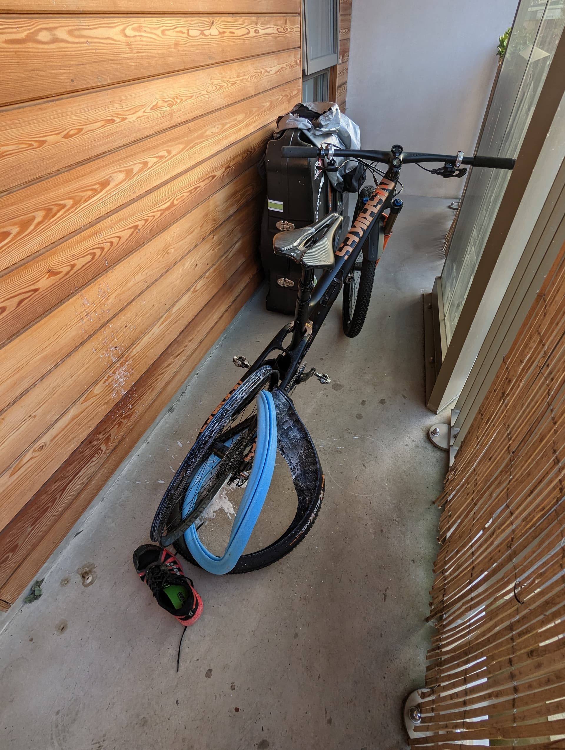

The next morning the tire needed a little more air but again I didn’t see a leak. That day I climbed Columbine and got to the top (or near top since the Goat Trail still had snow) and all was find. I started down the decent. The top of Columbine is pretty rocky and after bouncing over a few rocks I heard a distinct hissing sound and the rear when flat. I have Tubolight inserts in place so was able to roll easily to a stop on the inserts. Again initially I did not see a hole but after putting a little air in I found the spot. A pretty big sidewall hole had formed right on the edge of the rim.
I tried to plug it with several Dynaplugs and several Stan’s Darts, but after 6 plugs it was still leaking, so it was time to take out the insert and put in a boot and a tube. This allowed me to finish the ride.
I ended up swapping the tire out that night for a 2.35 Ikon as I had another day of riding planned. The Ikon held up fine the next day.
It may be bad luck, but I haven’t had a pinch flat like wth my ENVE M525s since I started running them around 2019. I’ve run a mix of Maxxis, Schwalbe and Conti tires along the way, so getting a pinch flat like that with the Kenda’s, with an insert in place, is concerning to the point that I wouldn’t feel comfortable using them for upcoming races (Leadville LT100, Leadville Stage Race). It’s a bit of a shame because the tire felt great otherwise.
