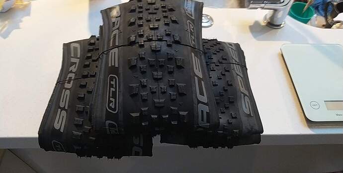

Still waiting (not so patently) for my Wolfpack Tyres to arrive. Trails are still super wet so it’s not like I’m missing out yet on any MTB riding yet.
Just recieved my Wolfpack Tyres.
Super impressed with the feel and weights. Haven’t installed them yet but will soon. I need to make a call before my A-Race whether to go for the Cross front or Race. The Cross weighing marginally less is interesting and removes one of the normal sacrifices of a more confident front tyre.
I need to see how the Race and Cross effect rolling resistance and cornering confidence on the front.
Cross - 29 X 2.4 - 719g
Race - 29 x2.4 - 728g
Speed - 29x 2.4 - 669g
I tried to get hold of a couple of Speeds in 2.4 for a dry spell we had in the UK but couldn’t find any stock. I stuck the Reckon race that came with the bike back on and it’s rained ever since. Will be going back to the Cross/Race setup in the next few weeks for my upcoming races

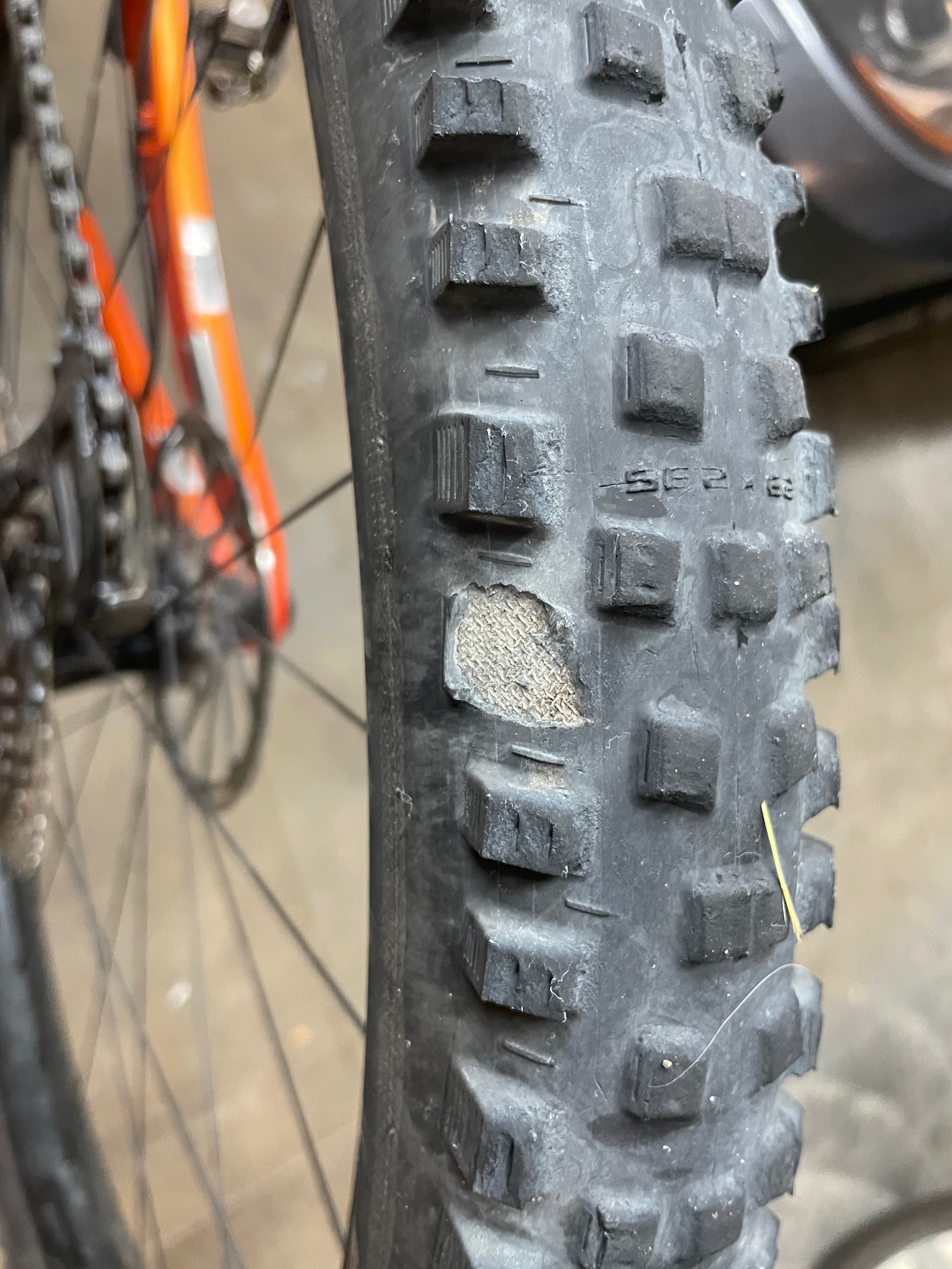

So figured I’d post here. I saw this on my Schwalbe Nobby Nic rear tire this evening. One of the side knobs is missing. Ripped right off.
Anyone ever seen something like this?
@DaveWh Never had that issue but I did have a sidewall issue with a Schwalbe tire and they were great to deal with and gave me credit for a new tire.
Thx. I emailed them a pic. Will see what they say.
I’ve never seen that before on any brand of tyre.
Woah, that’s a big hole. I’ve seen knobs ripped clean off of various Maxxis DH tyres, but never exposing the canvas like that. Usually just from hard riding and rough conditions.
How old are those tyres? They look like an older version?
I bought them in September last year. They are the 2.35s, not the current 2.4 generation.
The tire was on my list to replace, as it was getting worn. But I didn’t expect to see a side knob ripped off like that.
Same thing happened to me on a side knob of a Bontrager xr3 about two years ago. It was also a fairly worn tire that was close to replacement.
Side knobs shear off all the time on aggressive tires with soft rubber. I cannot however remember seeing one torn off exposing the carcass like that before. Also it typically starts to happen after the corner knobs are getting “undercut”. Your corner knobs seem to be in fairly good shape, with minimal chafing/undercutting
I emailed Schwalbe. Got the following response.
“We understand factory defects can happen from time to time and monitor all issues through our warranty form as part of our quality control program.
In this case, it appears there was an adhesion issue. We are currently out of stock of the 29x2.35 Nobby Nic, would you be interested in the 29x2.4 size?”
Replacement tire on its way!!
