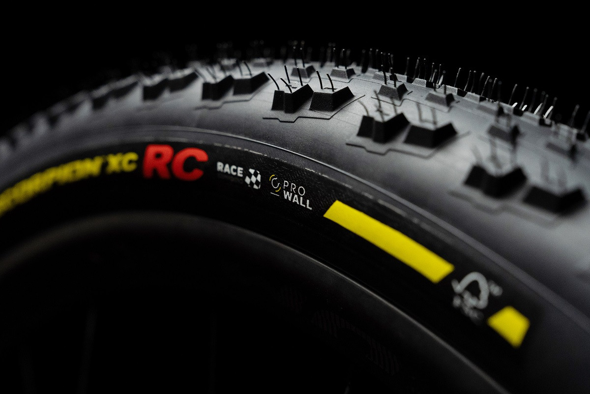

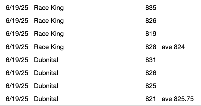

Thanks to @jkarrasch Pirelli Scorpion XC RC rolling resistance RESULTS
Via Is a MTB Tire the Best and Fastest Tire for Gravel Racing?
I think he tested the old version? Pirelli just released a “new” XC RC with “faster” compound.
Old one, yes. New one they say is 10% faster, so for anyone that likes the tread pattern or whatever, might be a good one for them.
