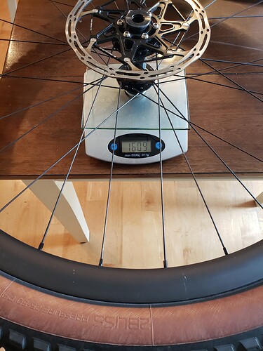

I had 2.3" Fast Traks mounted on 25mm Specialized Control wheels on my Epic. I just mounted a 2.4" Rekon Race on the front and 2.4" Aspen on the rear. The Rekon Race added 160g to the front. The Aspen added 120g at the rear. Measured at the knobs the Rekon Race measured 2.35", between the knobs 2.31". The Aspen measured 2.38" between the knobs and 2.4" at the knobs. The Fast Traks measured exactly 2.3" at the widest part. That measurement doesn’t include any knobs because they don’t sit far enough out to end up part of the measurement.
The Fast Traks feel a lot faster to me on smooth surfaces. The Maxxis combo adds a bit more grip but is 300g heavier and feels slower. I’m really interested in the results of @Jonathan test because it’ll likely end up more scientific than what I manage but I’ll report back.
The 2.3 Fast Trak definitely “feels” faster to me than the heavy 2.4 Aspen. We have to remember that we don’t get the “pro” only 170TPI Aspen that Nino rides. He’d probably use something else if he had to use the 120TPI Aspen.
