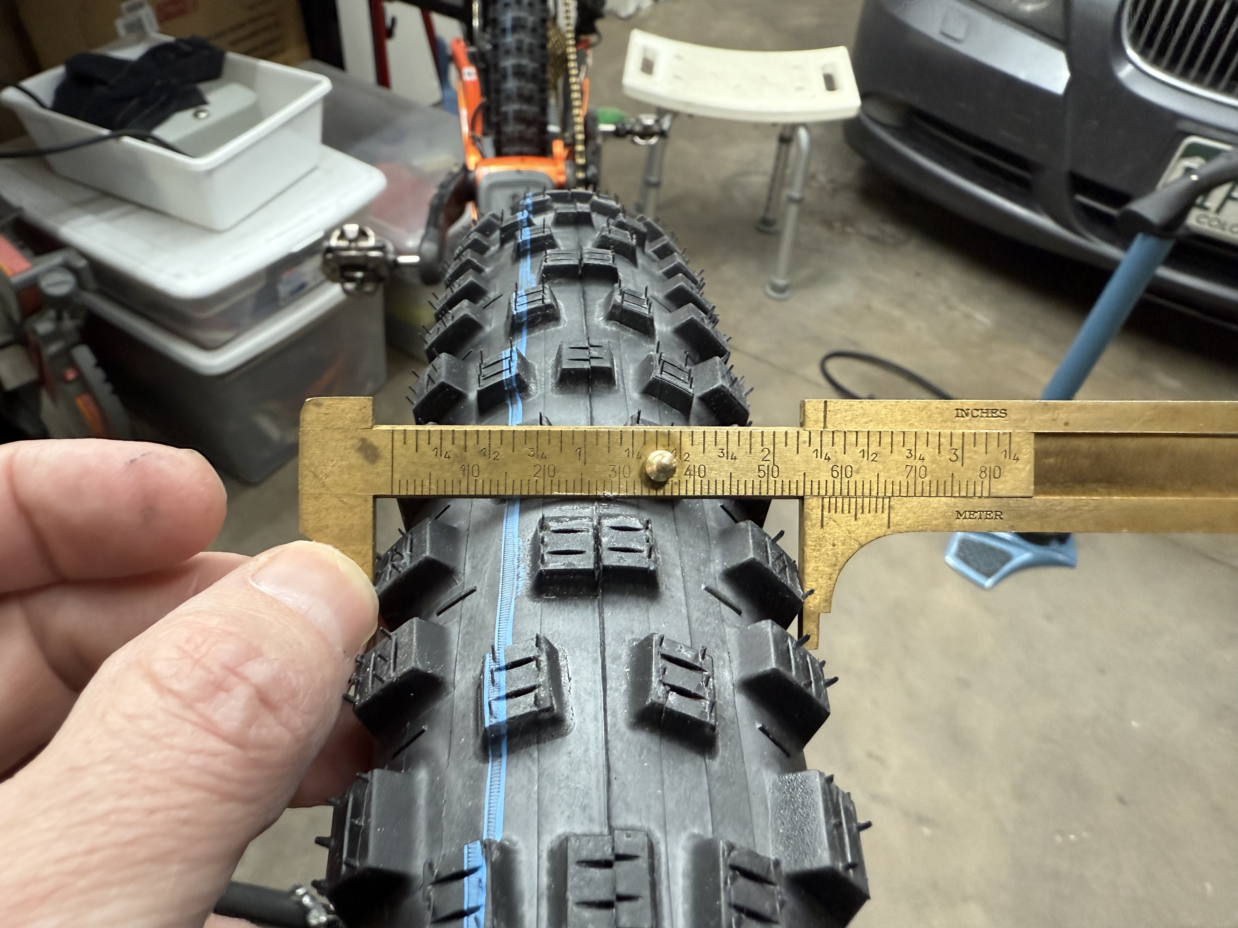

My Rick 2.4’s still measure no more than 2.28 inch after 2 months on my 30mm id rims.
I tried to widen them by inflating to their max. allowed pressure and leave them for a few days, but still 2.28".
I repeated this a few times but nothing works.
Disappointing to be honest.

Do you know the bead-to-bead width? My Nobby Nics are 152mm - and measure 2.25” when mounted. Im pretty sure the bead-to-bead width needs to be 160mm+ for tires to measure 2.4” mounted on 30mm rims. Agree , it’s very disappointing Schwalbe can’t get their act together on tire size, as the tires are otherwise quite good.
Unfortunately, classic Schwalbe. I wonder at which point this becomes an actual case of consumer mislabeling. The only way they could save face on this would be to state on which rim widths their claimed sized are measured.
