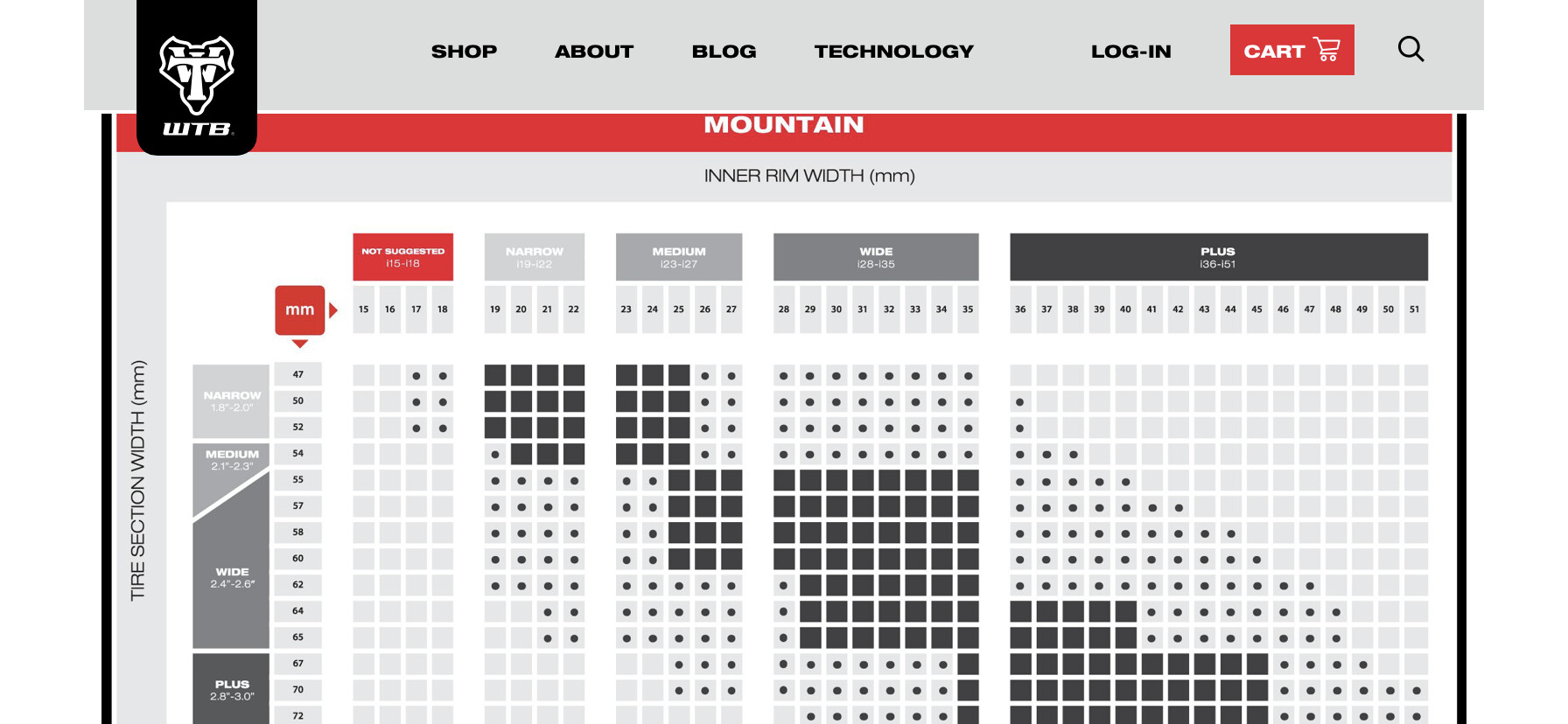

Thinking about replacing my 2.1 fast trak with a 2.3 on the rear. Think that’s too big or should be fine?
2.3 should be much better than 2.1
It depends on the course. 2.1 may be better for some courses as it’s lighter and spins up faster out of corners.
I race XCO, XCM and MTB 100s with 2.35 f/r Vitoria Mezcals and they’re great. I’ve tried to go back to 2.25 and it feels like a downgrade in cornering, traction and handling. In XC the current trend is wider with up to 2.4 becoming popular. So you’d be right in line with 2.3. Most go wider up front at the minimum, so I’m assuming your front is already 2.3?
Caveat, what’s the inner dimensions of your rims?
I have a 2.3 ground control for the front and this fast trak was actually my old front wheel. Wheels have a 22mm inner. Descending is still my biggest weakness so hopefully this will help out a bit.
22 id rims are a little small, but it looks like 2.3 should be ok. You’ll probably have more of a teardrop profile.
I think you will find that the 2.3 is just a tiny bit larger than the 2.1. I am guessing 2 mm.
The 2.1 was a bit big for its size and the 2.3 is a bit small for size.
It will be better though
Same boat here, every time I go wider with my wheels and tires, I am happier. I currently run 2.4" tires on 27mm rims and love it. I am 170lbs and can comfortably run anything from 16 psi to 22 psi depending on terrain. My next set of wheels will likely be >30mm. I started with 19 mm rims years back and found that anything over 2.25 felt a bit squirrelly trying to put the corner knobs into the right place on the dirt (teardrop mentioned above) and even pulled a tire off the rim experimenting with lower pressure. At 22mm, you are going to be on the higher side of low pressure to keep the tire in the right place but otherwise, Go try it out! Playing with tires size/types is probably the best way to change the feel of your bike and in the world of bikes it is relatively inexpensive.
