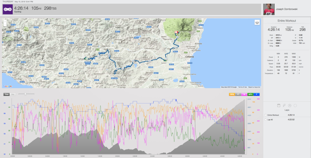

Here is Joe Dombroski’s file from a stage at the Giro.
On day 6 of the Giro when he tackled Mount Etna, Dombrowski had a total TSS score of 298. During this stage, Dombrowski was pivotal in helping to protect Michael Woods early on, as well as on the lower slopes of the cimb. In the opening 4km of the climb, Dombrowski produced 380w, 5.25w/kg for a 10 minute effort as he kept in contact with the leading group.
First, note the massive build of his CTL, with a staggering increase of 60 points over three weeks (from 132 to 192). This is a ramp rate which we see rarely in any other events or training blocks; only in a long Grand Tour like the Giro can riders meet such demands.
The monstrous CTL ramp rates come down to Dombrowski’s weekly TSS®. Logging approximately an 1800 TSS per week for 3 weeks is something most of us would fail to achieve even for 1 weeks a feat only sustained by the talented and elite of the sport.
Note the IF of .82 for a stage of the Giro and the subsequent TSS. I would say maybe retest your FTP?

I posted a leg of the Giro for a guy who turned himself inside out, enough to get an article written about his effort on training peaks. His IF was .82. Did you happen to see the hills Joe rode in the Giro lol. :metal:t4:

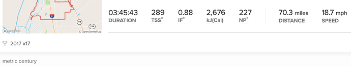

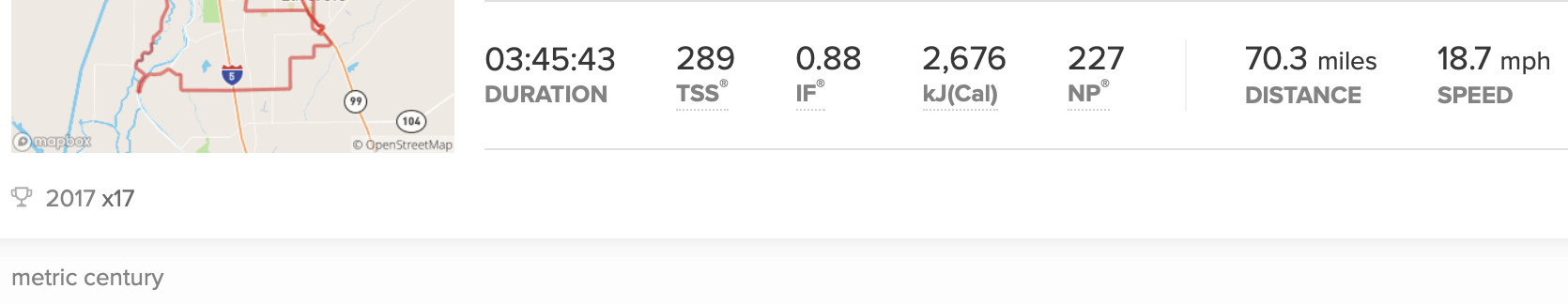

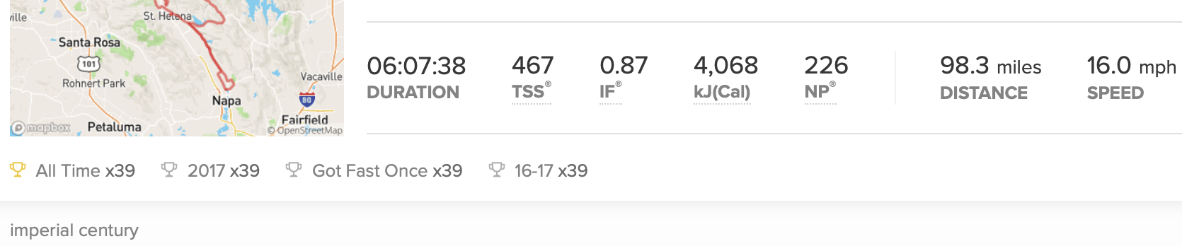

I’ve got a handful of rides like this (>3 hours and IF > .85), and modeled FTP in WKO is a watt or two from field tested FTP.
Here’s two hard group rides, with significant solo riding time:
and
and a solo ride:
back when I was training outside using Strava/CTS Gran Fondo intermediate plan and doing:

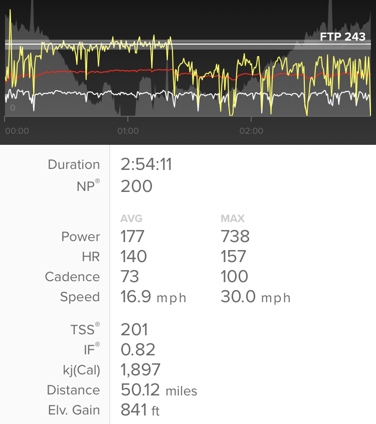

I’m working on getting back to that, and have nowhere near your power. FWIW here is a ride from 23 days ago where I ended the ride early to join the family for a hike. So not quite 3 hours but IF was holding around .84 until I decided to figure out parking before the family arrived by car:
Was fighting a wicked headwind for the first hour. Like you said, ride long distances, push the pedals hard, and keep stops to a minimum. On that ride the stops were just under 4 minutes before arriving at the park.
Just did a threshold test 3 days ago on Saturday, and made it 65 minutes before surrendering:
FTP is pretty close to 243. I could maybe bump it up a handful of watts, hard to say for sure :man_shrugging:
