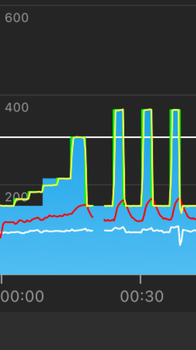

Here’s an example of me cutting two minutes out of a six-minute recovery before the work began this morning.

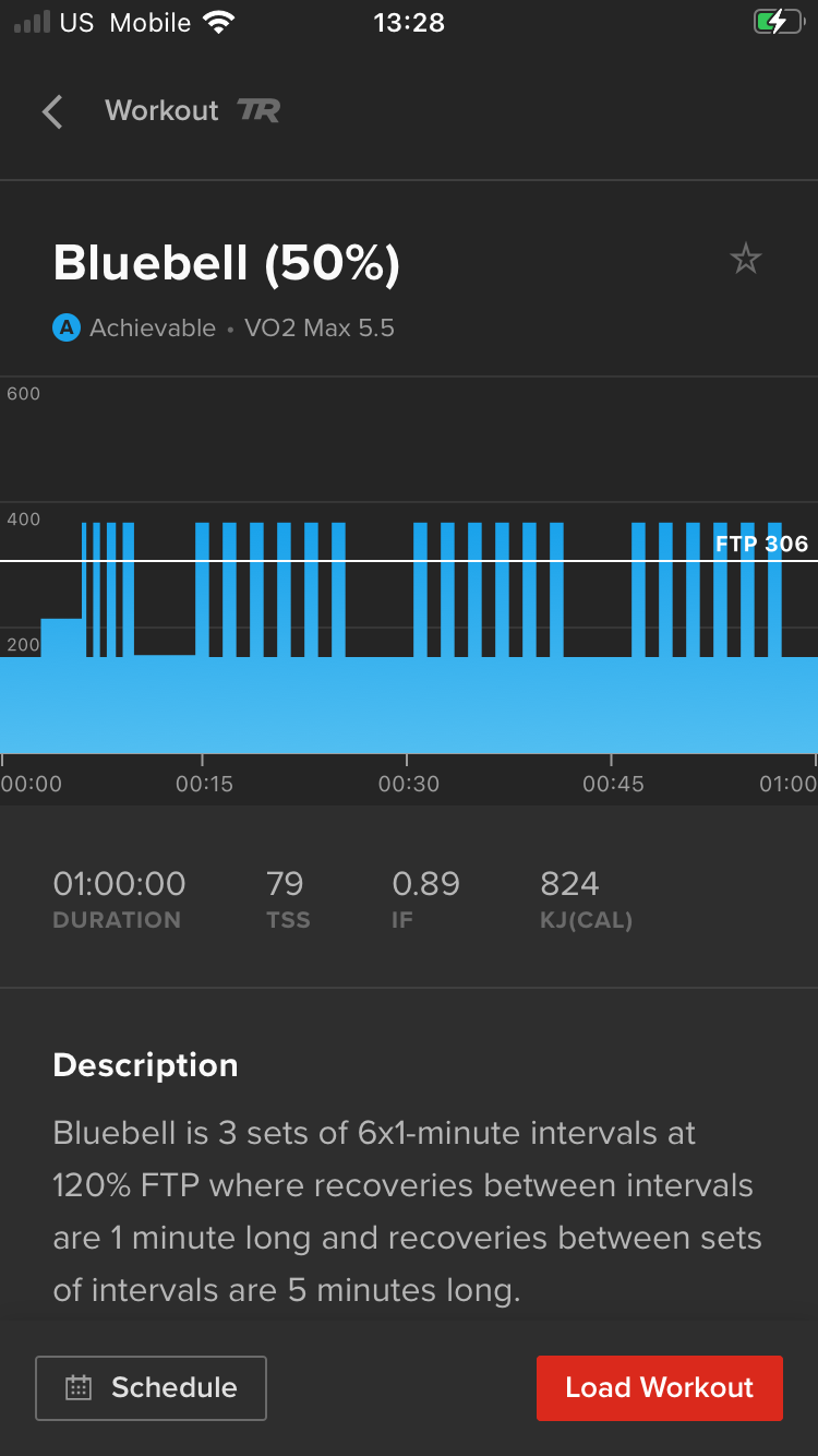

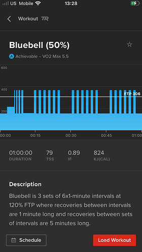

And here’s Bluebell but with 50% recoveries.
