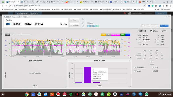

For all you LSDers, what % of your ride do you actually spend in z2? I feel like when I try to do a long z2 ride, my zone distribution still ends up being too much z1 (40%ish on a recent 3.5 hr ride), some z2 (25-30%) and the rest z3+ (I live in an area with a lot of rolling hills). Obviously this seems like too much z1, but what % should I be realistically aiming for?

From a ~6 hour z2 ride I did. Last 20-30 min was riding threshold between lights.
By power my breakdown is something like this of late; ~20% in z1, ~75% in z2, then rest tends to be under z6 due to terrain and gearing. It’d be nice to see 10% or less in z1 but I haven’t consistently done that yet.
My rides are like that too. I think to really stay in z2, you need somewhere pretty flat. If you have rolling hills, you need to ride up them really slow, and go really hard on the downhills. For anything over a -3% gradient (descent), I find it hard to keep power even in z2 (and not go too fast for the corners).
I like to follow the guideline that @brendanhousler put in one of his blog posts about endurance rides. That is to aim for <10% of the time under Z2. So contant pedaling and constant shifting to keep the pressure on the pedals. Depending on the interruptions on the route I am usually able to get close but any stop light or slow down really makes the 10% difficult. When you first start doing it you really do feel like you are going nowhere on the uphills of the rolling hills but you get used to it and it gets easier.
It isn’t so much “hard”, as “fast”…your power should remain in Z2, so you aren’t pushing that much harder…but even that Z2 power means you go faster than you normally would downhill (when most people coast or recover).

I find it relatively easy to hold Z2, on my Z2 specific rides I always manage at least 90% of the time in zone
KUDOS MAN!! yessir, less than 10% is really hard!!! (if you live in a mountainous area, don’t kill yourself, and aim for 15% or so depending on the duration of the down hills).
Agree, it would be difficult in a mountainous area. You can also just ride the hills at low to mid tempo and try to keep the np for the entire ride in L2. Not really much different adaptations…
