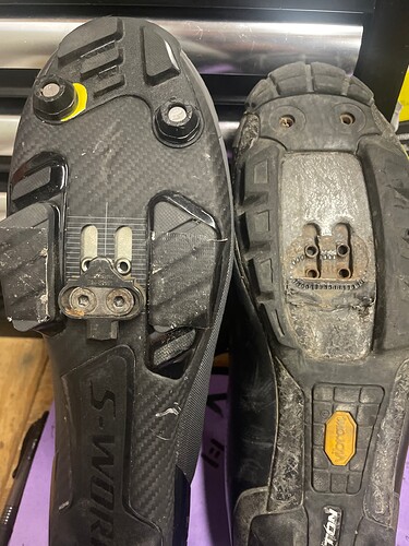

I’m in Giro VR90 2-bolt SPD shoes. He immediately commented on how narrow they were for my foot shape and noted that I’m incapable of spreading my force through the entire foot bed, and most of the pressure is on the lateral side of the shoe. He was more eloquent in his diagnosis, but bottom line: This is causing all sorts of issues.
He also noted that Giro shoes have a very limited cleat placement range and said he wanted mine to get even further back. They are already in the rear most position.
I took his direction and bought a pair of S-Works shoes and immediately noticed they fit a lot nicer. My feet have more room, and I can get the cleats much further back…effectively taking more of the knee out of the pedal stroke.

Look at how much further back the cleat is in comparison!
