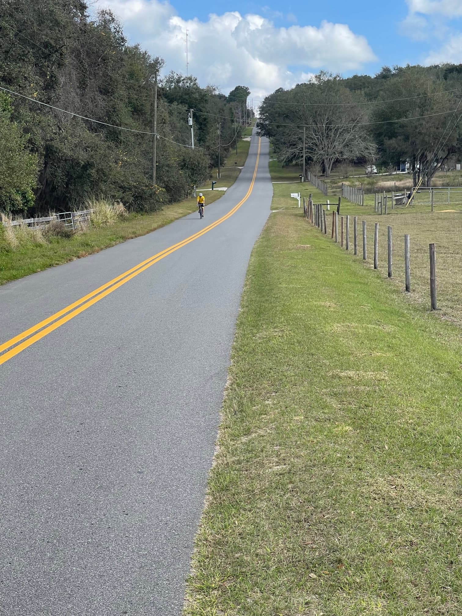

Testing…man it is difficult to know what is going on here because all of the runs look about the same! Paved, 8%, 190 feet of elevation gain. I thought I could easily prove the light hardtail with thin casing tires would be faster than a heavier dually with maxxis exo casings but, heck, even the big knob ardent EXOs ran about the same.
Do you think the times would be the same if you always trimmed the weight to the same? I mean add weight in all configurations to exactly 230 (assuming units are pounds)? That seems to be the variable out of control. Also, was the suspension open (unlocked) or closed (locked out)? I can’t wait till the snow is gone now to give this a try. At least you got a good workout.
