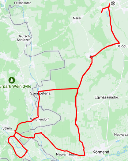

3 hours on the drop:
102 km, 303m elevation → 205 W with 33,1km/h
My BMC Roadmachine is not an aero frame, and my DT wheels neither.
