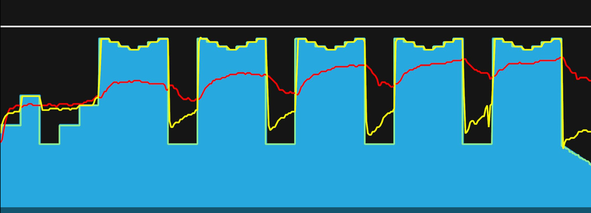

this was my sweet spot workout yesterday in erg mode on new atom. I am not sure I had the new beta firmware running so am happy to see if tomorrow morning any different. the biggest surge I saw was probably up to about 360 from a target c.285. not terminal in a sweetspot workout but could be in threshold or above. When I reviewed each interval the average power was pretty much on point but you can see the variability in the profile which is the issue. Feeling like I should have done more DD before pulling trigger and paid a bit more for the KCKR bike.

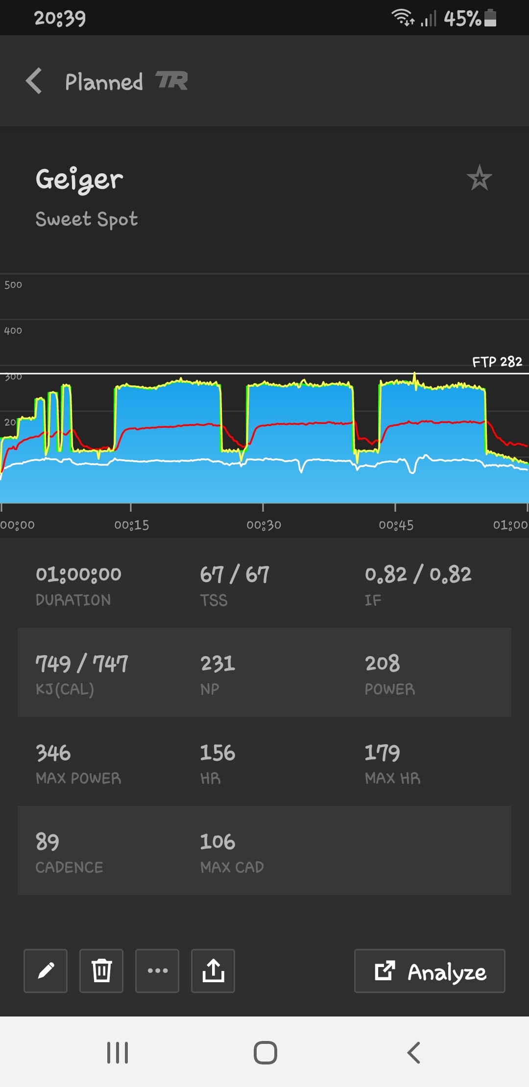

Anyhow…this is how the above mentioned workout looked.
Note the jumpy power near the start is me doing single leg drills and during the sweet spot intervals I was doing some cadence drills and the transitions really felt smoother
That looks much better! Temped to place an order if that’s representative of current ERG mode performance.
That looks incredible. I have seen nothing close on my rides so will give it a try again.
I should fit in another ride again today and try to remember to report back in here.
I did the same workout on my Kickr Snap - it looks like the WB is still some way off this!
@Tom_Gurden - I forget to do the ILT drills at the start - otherwise I am sure that section would have been all over the place. Also, I am no where near your level in terms of FTP, but I’m not sure that would effect the ā€œsmoothnessā€ of the trace in ERG mode.
Hi, it looks as though you have some kind of smoothing on? I think there is a setting somewhere in the wahoo system?
I’m not sure what to expect in terms of fluctuations in erg mode but I believe that all trainers have to have them…it’s just how quickly they react and then settle. Yours seems to be flat lined all the way.
I’m not sure FTP really has any effect but I am comparing like for like to similar workouts at a very similar FTP.

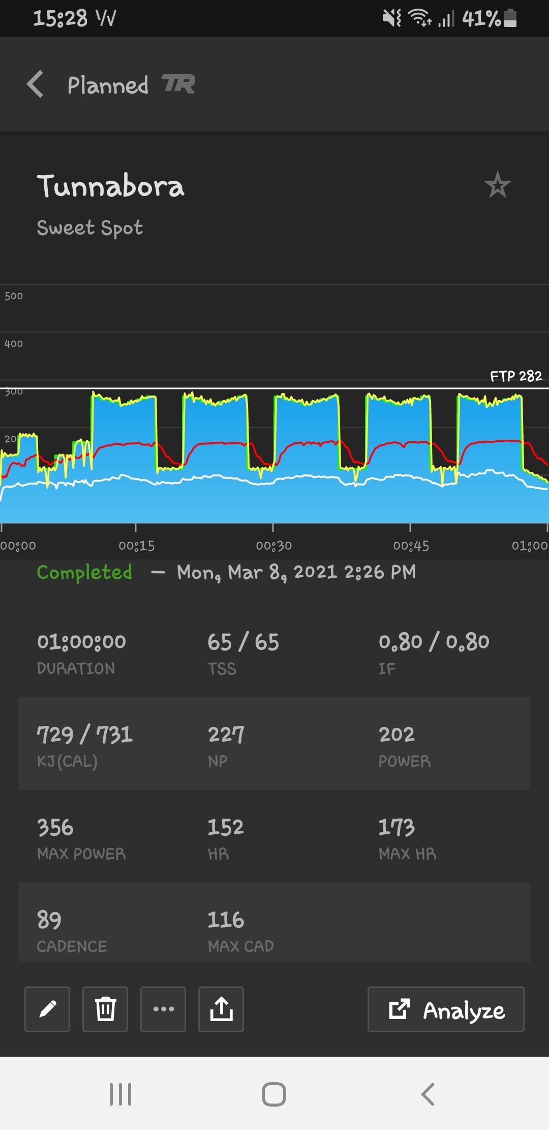

This evenings rolling sweetspot workout and I can report much the same. It was a little bit ā€˜choppier’ this time but I think that’s more to do with me not feeling as strong/smooth and shifting about a bit/changing cadences and my watts might jump or drop by 20 or so but then quickly settle again.
I’m not sure it makes any diff in the graph views here but I have my power smoothing in TR set to 0 seconds.
All in all I think it’s improved a ton from.when I first received it 5 months ago!
