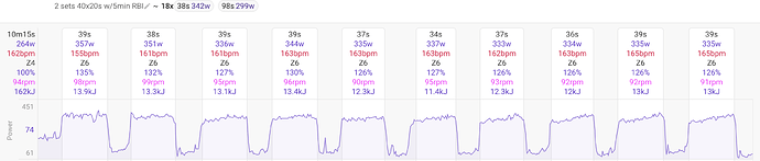

I went back and found a representative 30s interval from my last Grassy Ridge workout. It looks like the slew rate of the trainer delays target power until about 20% into the interval. On the other hand, it delays the drop in power a similar amount at the end of the interval. In the end, all the 30s micro intervals were 2W to 3W under target power. My only observation is that I’m unable to do better in resistance mode.
Both of these with Stages power meter…
RESISTANCE:
Intervals.icu approves of these 40/20 second intervals in resistance mode, this was the second set.
ERG:
TR’s Taylor -3 in Erg with power match, these 30/30 second intervals also have well defined edges but some fighting with erg.

just updated that post to also include a pic showing erg/power-match.
Here’s some of Grassy Ridge +2 in erg mode as interpreted by intervals.icu. So, as you can see, either trainer manufacture or intervals.icu setting can make a difference. This data is taken from a low-end trainer (sub $700, purchased 3 years ago) so maybe it’s the case that cheaper is better for these micro intervals? Anyhow, intervals.icu catch micro intervals pretty consistently for me. So that’s interesting. Not sure I understand why the difference but it’s more proof to the assertion: your mileage may vary.
Forget about intervals.icu recognizing them, part of the problem might be that I don’t really use intervals (I think Taylor -3 is >105% and my ftp isn’t set correctly).
The erg ones show a little more power variation, and I often see some overshoot and ringing. Maybe I’m fighting a bit with the Kickr, or maybe its the Kickr. IIRC DCRainmaker posted in a review something about Erg and a feeling of ‘fighting’ with it on TR. It is a minor thing, nothing to get excited over.
In any case, the resistance ones are a bit smoother. Resistance (standard/slope mode in particular) definitely feels more natural to my legs/brain/body. In all cases I was using Stages crank arm power meter.
