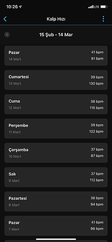

I also recommended you to monitor your resting HR, preferably in the morning, just after waking up. An increased resting HR is a sure sign of fatigue.
I am using fenix 6x pro and these are my resting hr. I am 29 years old and 76 kgs. My resting hr 36-40 bpm range which can be count as really low right? But these days 38-39-40 bpm. Btw my max 180-182 (i could see them only ramp tests and races, normally 176-177 in workouts if i am fresh i guess).
