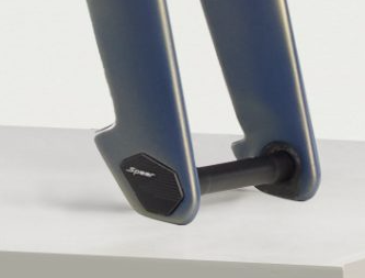

My question is… I will need to be able to focus elsewhere… respond to work questions, send the odd email etc, so I don’t want all my focus to be on not falling off. Is there any option or hack to keep the bike in place, for example something that grips the front wheel? I have seen the fork stands, but my main bike has a closed off thru-axle thread (see pic) so this won’t work. Plus if I can avoid taking a wheel off, even better.
I think your only options are Wahoo Rollers, or Kreitlers with a fork stand, which would mount to the thru axle as normal.
The wahoo rollrs are very badly reviewed, but I think would actually suit my use case perfectly. Unfortunately they are way overpriced and I can’t seem to find any 2nd hand stock anywhere.
I have these with the mag resistance drum too. Brilliant product. Can hold 550-600w - the rollers, not me. I have no interest really in Zwift, so the smart option not needed.
If your wheel is an old style quick release (vs thru axle), you could easily build a stand and use one of the fork mounts that people use for vehicle carry: Amazon.com : MBP Alloy Quick Release Fork Mount Bike Block (9x100mm) Truck Bed/Rack/Storage : Sports & Outdoors but you’re taking away all the fun and benefit of rollers
Check out the Feedback Sports Omnium and Minoura FG542 that are adaptable for stand mounts with compatible options for your axle.
