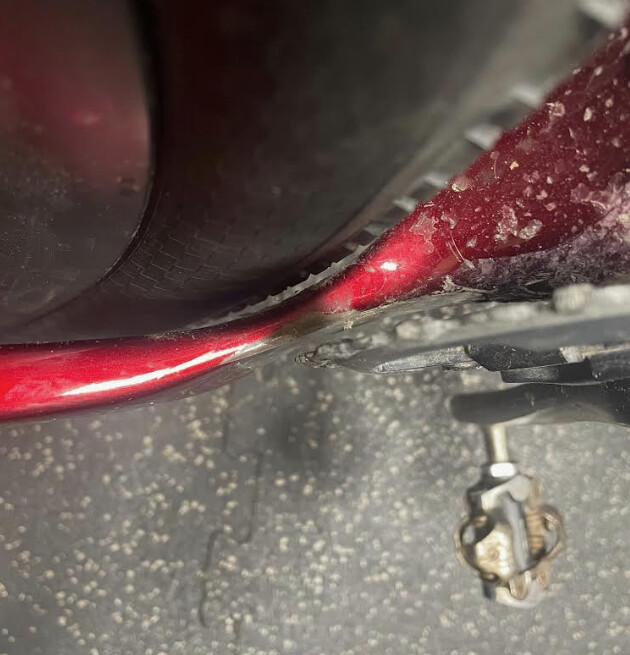

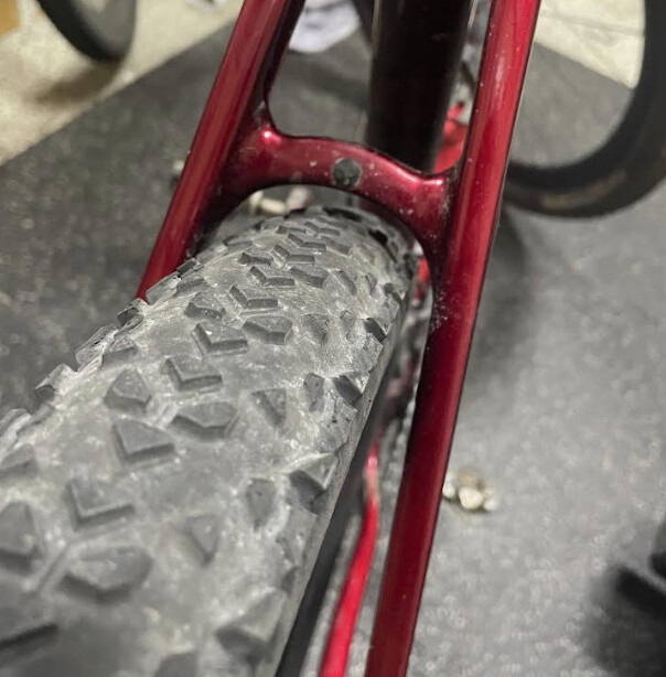

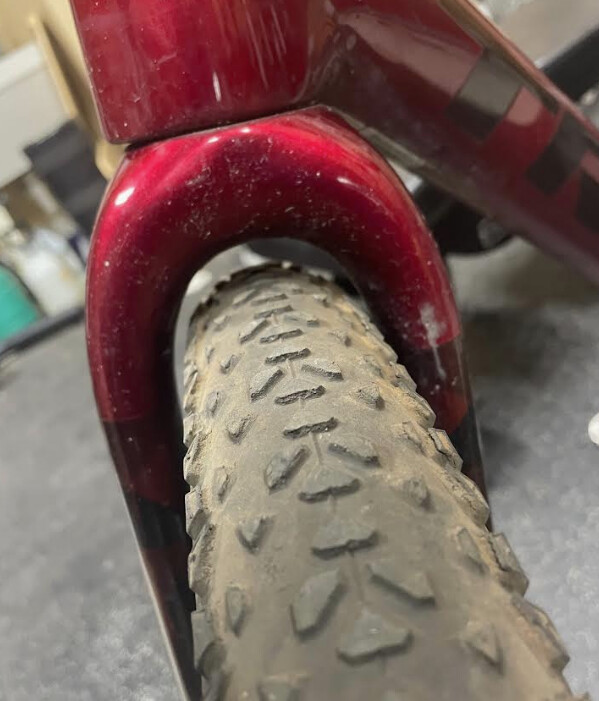

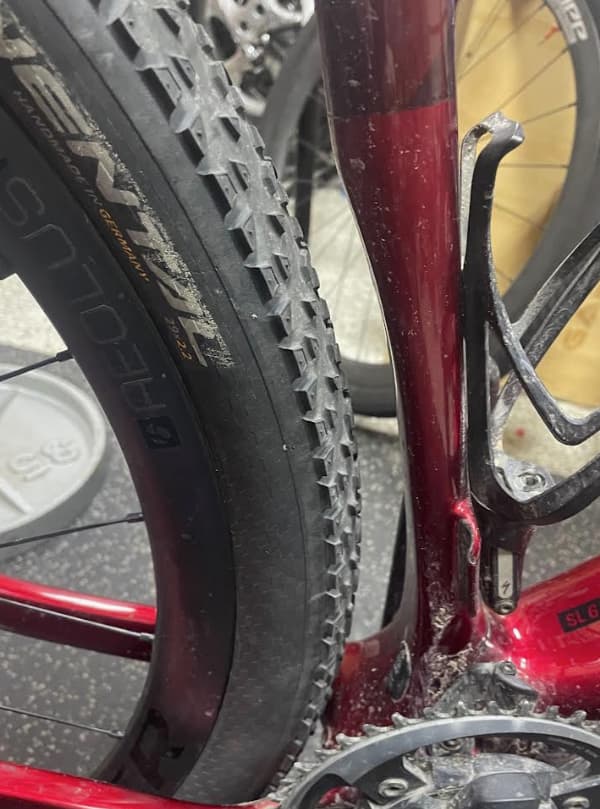

Messing around with tires for an upcoming race and thought I’d see if race king 2.2’s would come close to fitting my checkpoint. I believe my frame is officially rated for 45’s, but it fits 47’s with pretty good clearance. I still didn’t think the 2.2’s had a chance, but they fit better than I expected. Bottom line is that I wouldn’t hesitate to run one in the front (even with a little mud), but the rear clearance probably isn’t enough even in dry conditions.
A few pics - Decent up front
Decent on the seat stays
Decent on the seat tube
Deal killer on the chainstay (2-3mm clearance)
Yeah even in dry conditions, your tire will depress when cornering and such and rub those chain stays. My thunder burt fits the same in the rear. Has tons of clearance but the chain stay is like 2mm. I rode it in wet sloppy gravel conditions for 60 miles yesterday but since nothing really caked on my tires it didn’t rub any more than normal riding. My bike is titanium (raw in the chain stay) and you can see where it has absolutely rubbed on the chain stay. If it was carbon fiber it would probably do some damage pretty quickly, even without mud.

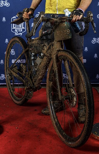

My bike at the finish in 2023. I recall taking this photo was an unlock to a complimentary bike washing. I asked the guy with the pressure washer to keep the spray nozzle at least a foot away from the bike. The spraying cleaned off most of the thicker dirt, but I still needed to do a deep cleaning when I got home.
