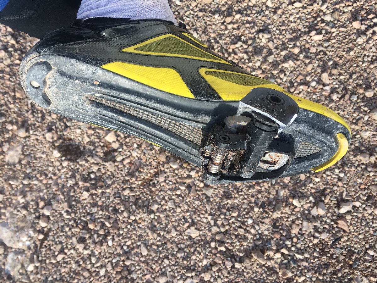

A crank snapped because an ultra endurance cyclist had a power imbalance?
Apparently so, I’m sure it was GCN who reported it at the time as I was following his progress on there.
The crank snapped close to the pedal spindle and it was stated that his broken elbow had caused an imbalance due to the way he was holding himself on the bike.
Whether they could see that from power data I don’t know!
Found the tweet, assume it was a Dura Ace left side crank. You can see the clean split from the bonded halves. I don’t buy for a second that this was from a power imbalance, especially if that explanation is coming from GCN.
I’m only repeating what was said, where GCN got that from I don’t know.
Maybe they said that to save Shimano’s embarrassment?
Ah ok, it sounded like you accepted the power imbalance might mean that the break was understandable.
My point is that cranks shouldn’t be breaking underneath 2000w sprinters, let alone an endurance rider, regardless of imbalances.
