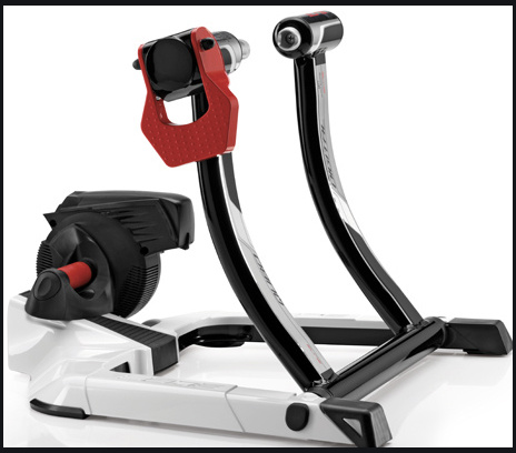

Maybe, maybe not. Some trainers like the Bkool and older Elites use the rider weight and not actual roller compression:
Based on his comment, I wonder if this is the style he has?
Ach so - maybe then.
It is a bike nashbar fluid trainer that isn’t on their website anymore, but it hinges such that the weight of the rider goes on to the roller. So when I use high pressure, the small roller must create so much pressure that I get the blowouts. Now that I am looking at other trainers, it seems that it must be too much weight than was ever anticipated for this trainer?
Yes, it is like that trainer
