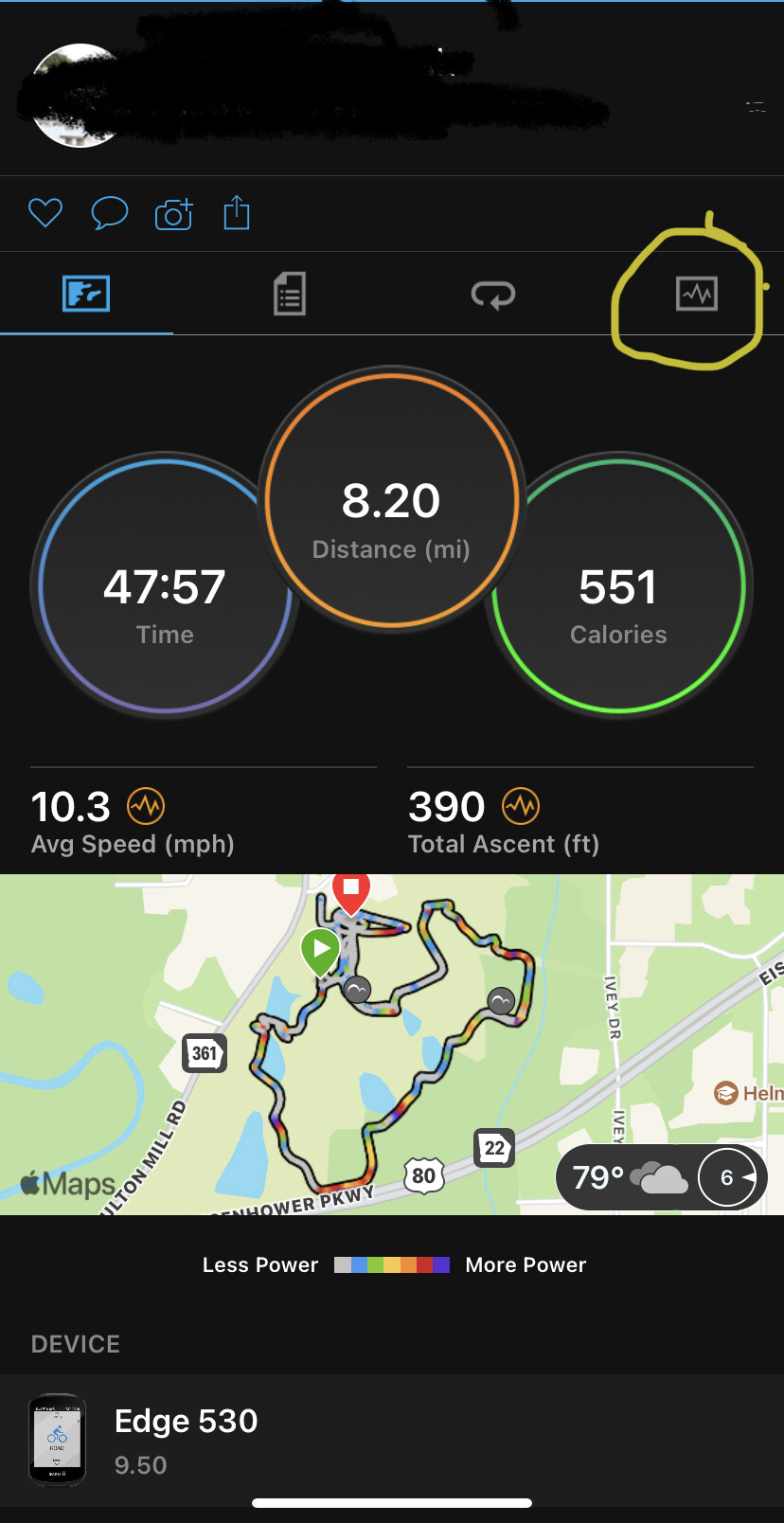

Where do you find this comparison?
Agree on the combo Garmin and TR for outside workouts. From May to September i basically don’t touch my trainer.
Damn thats a pretty graph! Kudos to you sir! Mine always look like my 4 year old is trying to follow the line and almost entirely failing.
I have a garmin 530 and find the graph on the garmin connect app. From there I click on the ride and it has more information inside, all types of analytics.
Click the yellow circled area…
Not sure what other garmin devices do the same.
